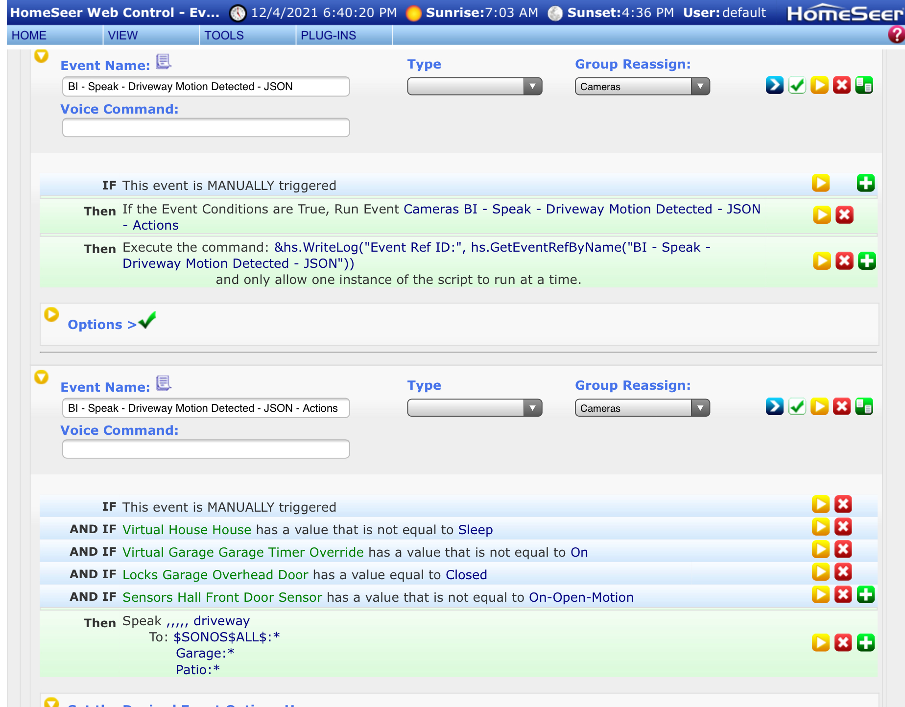

You can run events from HomeSeer directly by issuing this command:
192.168.0.2/JSON?user=USER&pass=PASWRD&request=runevent&id=281
This will trigger event #281. To find out the event number, write an event like this:

@JNDATHP

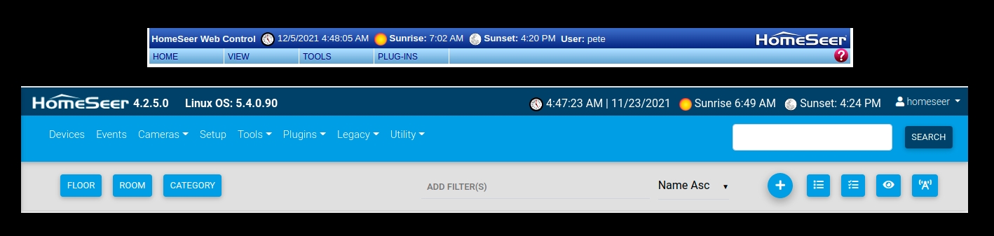

Many thnaks for the syntax - I wil lgive this a try before resorting to plugins. Also thanks for the screenshot - may I ask what version of HS you are running as I fail to be able to gett o see such summaries? This could wellbe down to my lack of knowledge of HS4.

Looks like HS3.
Here is a picture of HS3 and HS4 running. HS4 is running with Jon00 Links plugin.
Homeseer 4 Jon00 links app gives you some HS3 links.
