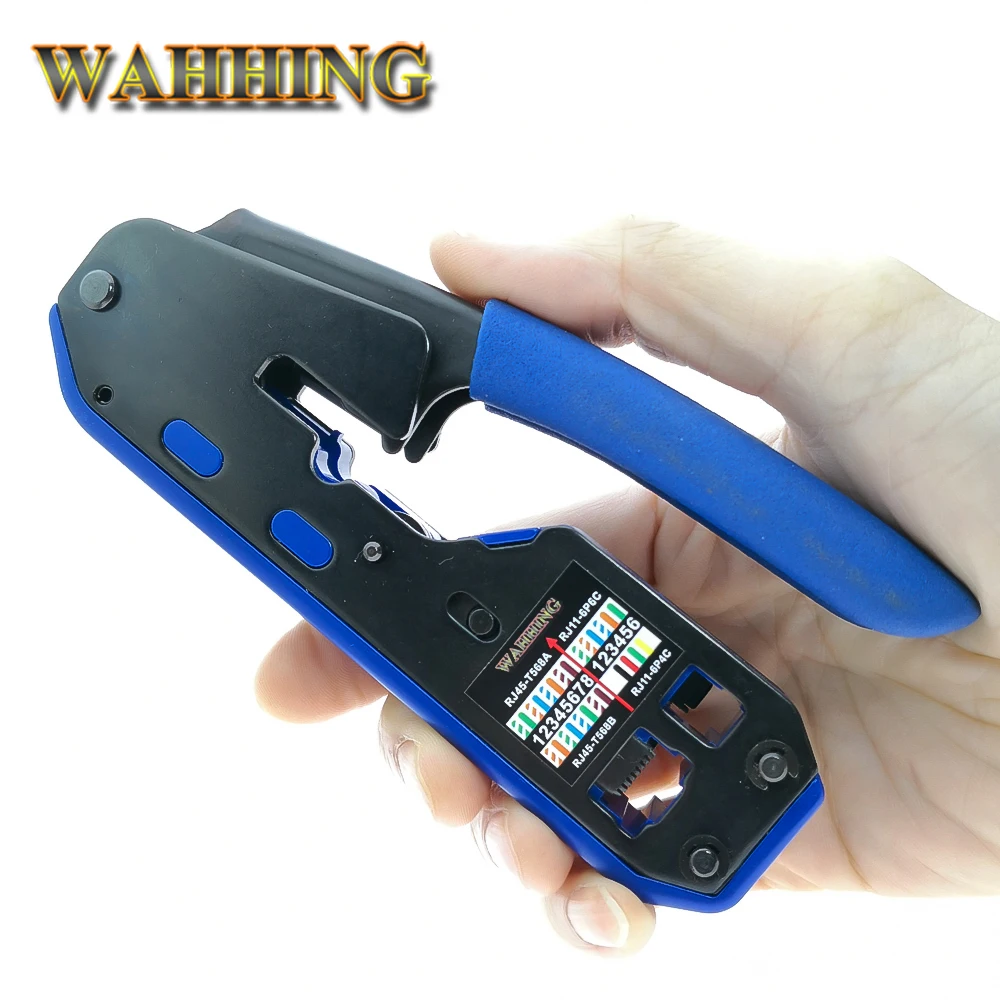

- Good network cable strippers, rj45 crimpers, and punch down tool.

3. Klein tools VDV226-110 chinese rip-off

drywall cutter.jpg anchors.jpg download.jpg pull string.jpg crimper.jpg fluke.jpg
installation tools? oh boy.... lots of toys for this :) Of course, not everyone can spring for the Fluke DSP-4000 unit (I have one since wire installation is my day job). But as above, a wiremap tester works great.
