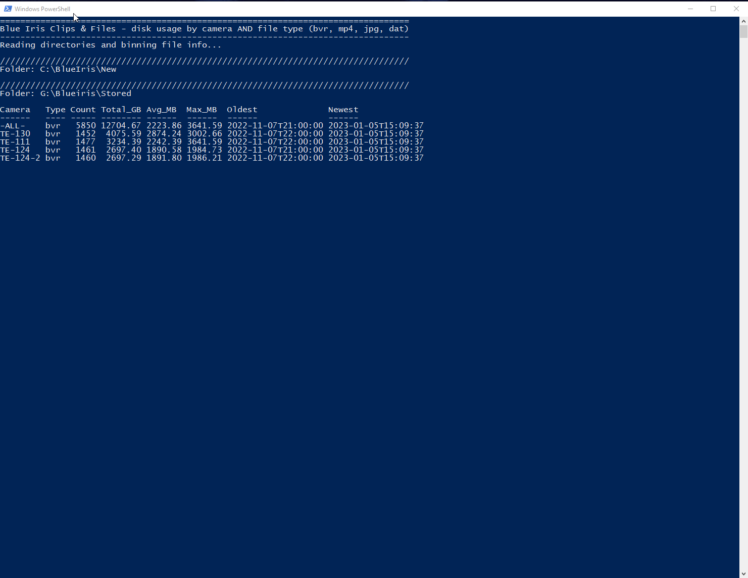

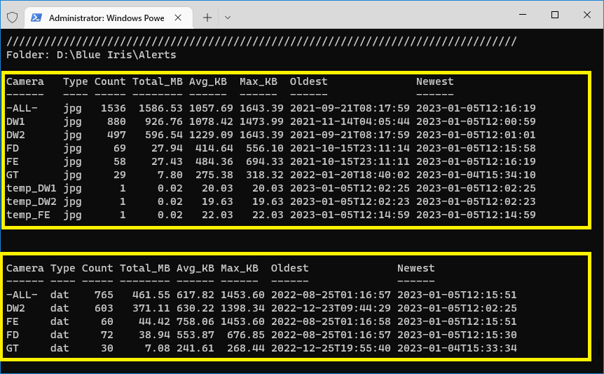

The following screenshots illustrate typical output - in this case for the 'New' and 'Alerts' directories.
Other directories can be summarized as well (see 'Customizing' below).
  • Each table summarizes usage for a single file type, e.g., *.bvr.
  • File usage is broken down per camera. The oldest and newest camera file dates are also listed.

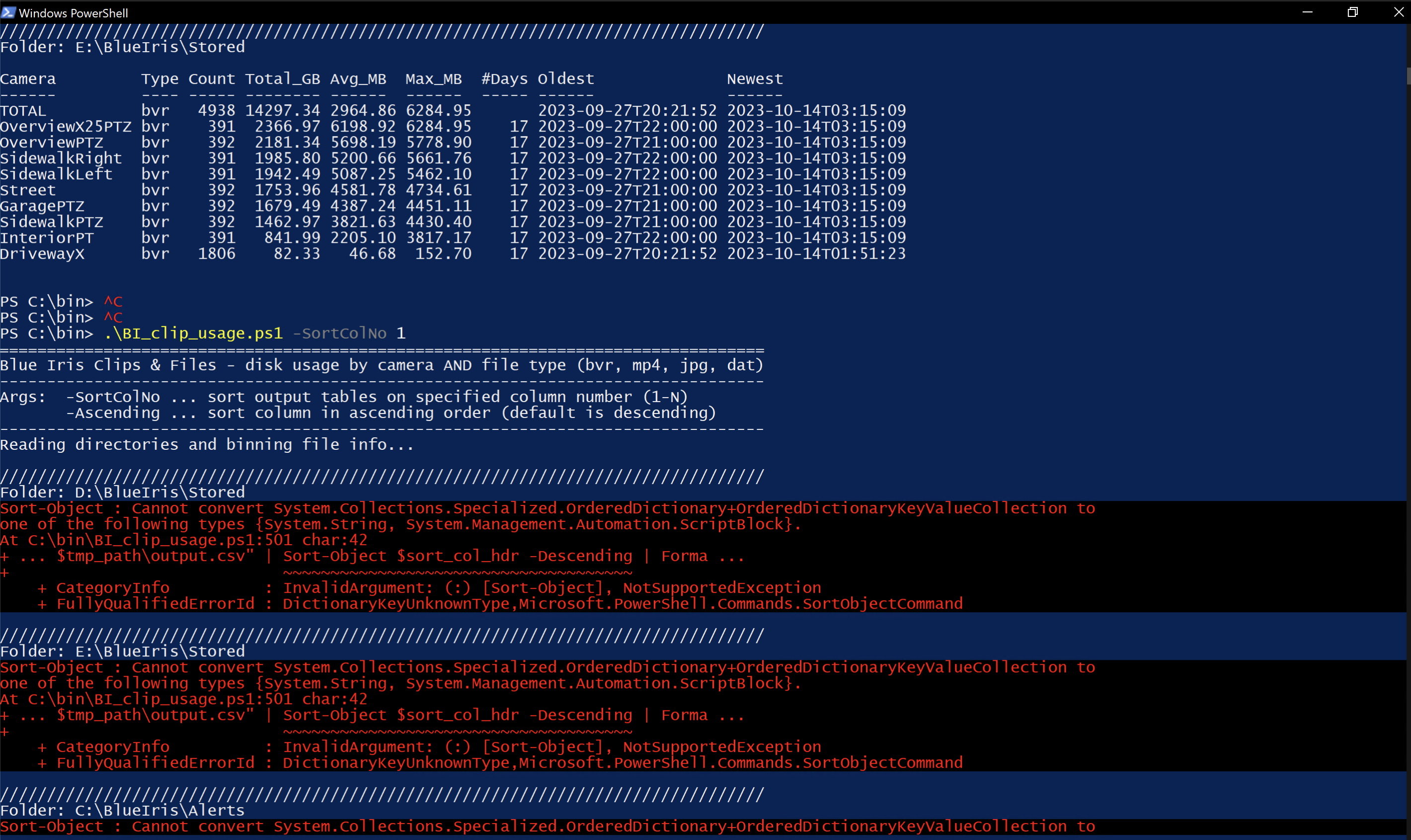

@jaydeel v3 scripts works fine without args. Then I ran it a 2nd time with-SortColNo option and got the following...

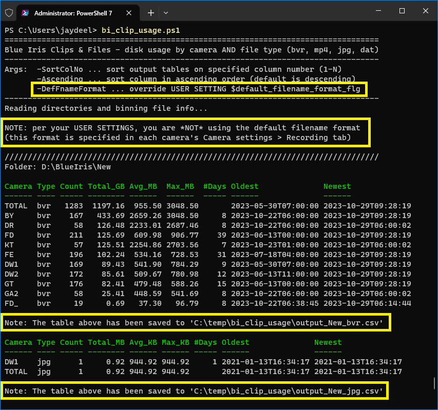

Script updated to V4. see post #1 to download the file
this new version may helpful...
  • if you do NOT use the default file format (Camera settings > Record tab) ... see changelog items 1-2 below
  • if you want to save results by each folder/filetype ... see changelog items 6-7 below)
Changelog:
  1. NEW: added support for Record tab non-default file formats, e.g., &CAM\%d-%m-%y\&CAM.%Y%m%d_%H%M%S
    added new user setting $default_filename_format_flg
  2. NEW: added new -DefFnameFormat argument (to tempoarily override user setting $default_filename_format_flg)
  3. NEW: added new user setting $alerts_folder_path; script no longer assumes the Alerts folder contains the substring 'Alerts'
  4. BUG: fixed issue resulting from $sourceN values pointing to drive letters only, e.g., $source3 = 'D:\' or "D:"
  5. CHANGE: changed folder used to store the script's temporary CSV files from 'C:\temp\bi_clips_usage' to 'C:\temp\bi_clip_usage'
  6. CHANGE: script no longer creates only a single temporary file 'output.csv file', now creates a separate file for each table displayed, like 'output_Alerts_dat.csv'
  7. NEW: added display message showing location of the script's temporary CSV files
The following screenshot shows the new USER SETTINGS.
This screenshot shows new features in the Console output.
Finally, thanks to @joshwah for pre-testing this new version.
