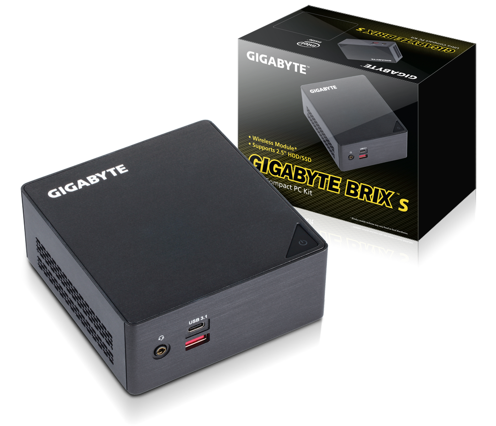

My server : GB-BSi7HA-6500 (rev. 1.0)
BRIX / Ultra Compact PC kit

It is not a laptop, but a sort of intel NUC :
Maybe it has a laptop processor ?

your processor is the problem. Intel may call it an i7, but the i7-6500U is still only a dual core processor. Even something "last generation" (like an i5-8400) would absolutely run circles around it.
You probably need to move away from the NUC form factor and look into something like a SFF desktop. They don't take up much extra square inches on the desk (although of course they are way taller), but you will be happier in the long run. The NUC form factor can't deal with the heat from higher powered multi core processors.

@susu03mat Hi and thanks for this info. Is the computer that i have chosen well adapted to BI? In terms of CPU i guess.
The computer you linked has an i7 9700 and is massively more powerful than what you have now; it should be up to the task with some room to grow.
