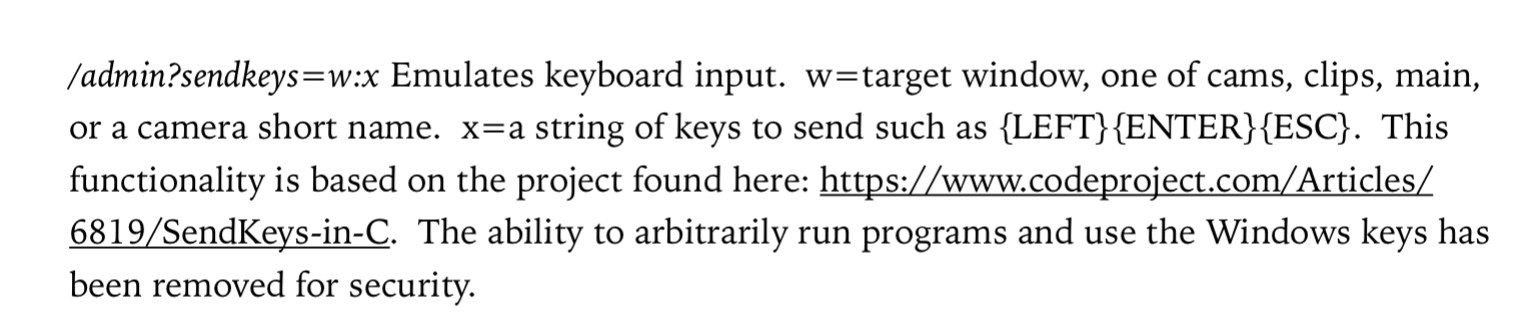

Check out this HTTP interface command…
For example…
/admin?sendkeys=DW1:{ENTER} will select camera shortname DW1
And any of the following will return to grid view
/admin?sendkeys={ESC}
/admin?sendkeys=main:{ESC}
/admin?sendkeys=DW1:{ESC}
More key codes can be found here
SendKeys in C++

Disregard! I got it figured out! I was able to get this setup by using the following commands admin?camera=X&escape for grid mode, and admin?sendkeys=camshortname:camkbshortcut works flawlessly!
