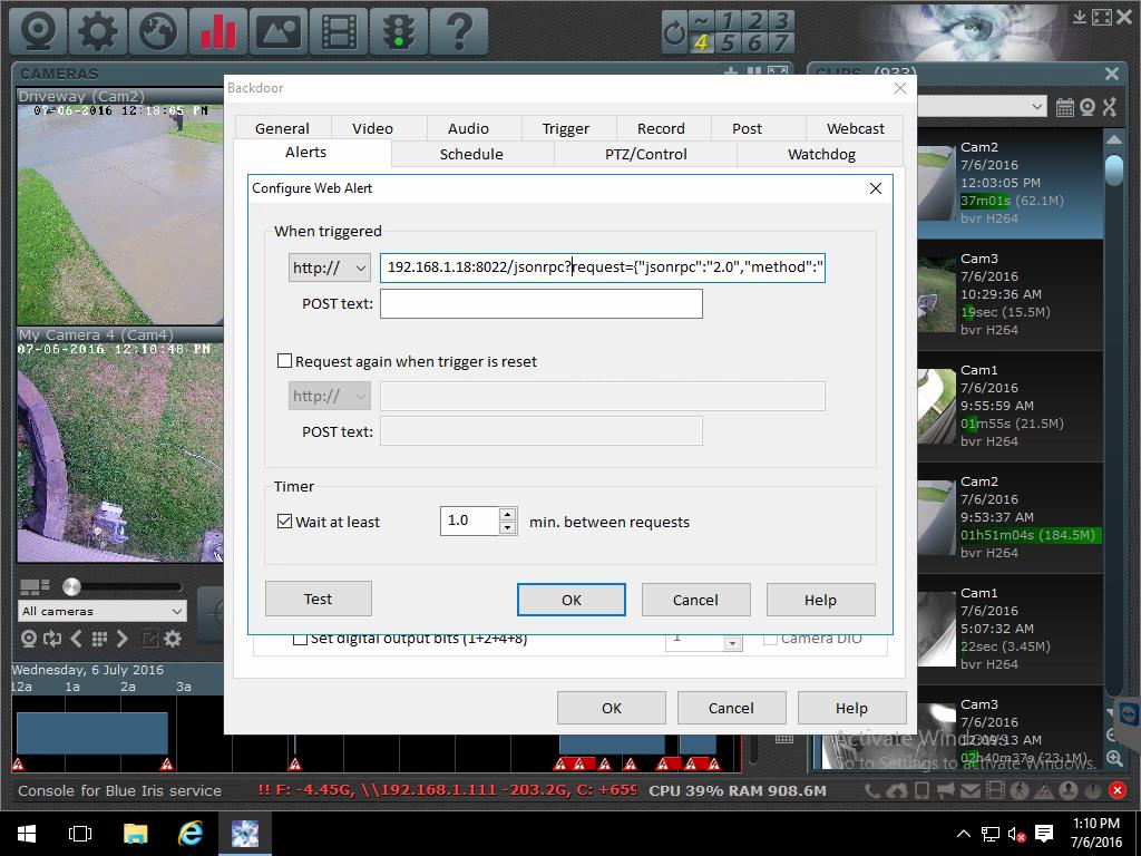

Im using this feature to hit my TV-Kodi using this address. So when theres motion I have it sliding in the corner of my TV
192.168.1.18:8022/jsonrpc?request={"jsonrpc":"2.0","method":"Addons.ExecuteAddon","params":{"addonid":"script.securitycam"},"id":"1"}}
But I want to hit more than one IP So I guess I need to make a little batch file or something, Can someone help me out?
Thank you
