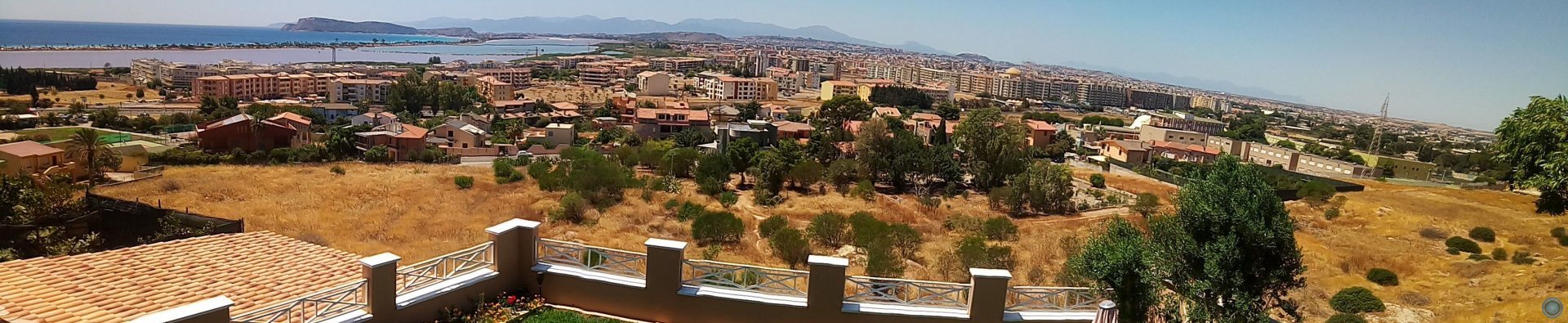

Hello everybody I have a good opportunity for installing an ip camera in a very panoramic zone of my town.
My dream is to make a sort of youtube channel in order to be able to show my city weather conditions (it will be very useful for sea activity).
This attachment is a part of the view ;);)
I have a small budget <500 Eur, but I'm quite confident to be able to make all the installation by my self.
The question is: which camera??
I PREFER 4k 8mp but I can choose also 4mp if I could be able to have a PTZ camera with a live streaming like this (look at the end of the video):
