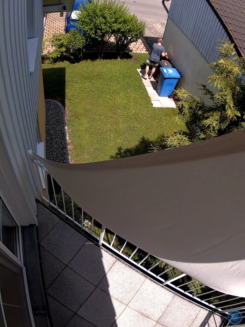

I am still more than satisfied with the video quality (day+night).
Of course there are better cameras out there but I guess not for this price.

This still image shows nothing. Aside from the fact that its noisy as is, reolink has a nasty firmware gimmick that lowers the exposure to 1/12 in low light making still images appear acceptable but causing any movement to apprear blurry.
This is in addition to the fact that they are a lying scamming spamming company. Their firmware is not compatible with blue iris as you cannot set the iframe interval. This will cause tearing in the video when using direct to disc.
But wait, there is more, that design will bless you with spider webs nightly in warm weather.

That video is completely dark the cat cannot be seen. A great example of why your motion activated led spotlight is a terrible idea as well as mounting the camera 20f up.

Well I can see that it's a cat. No need for me to count it's whiskers ;)
The reason why the cat can't be seen on the second half of the view is because there is a sail mounted on my balcony.
I mounted the camera in this position because I also wanted to monitor the balcony door with the same camera.
I would gladly mount an external IR floodlight if I could find a reasonable priced one that can do the job.
