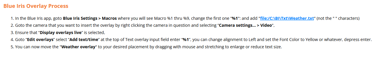

This works brilliantly, thank you. It did not take much time to do and the documentation was spot on, except for below.
The only issue is the file path given for the macro. It should be "file:/........" You are missing the additional /.
I would also suggest restructuring the order of instruction so that a weather.txt file is created first, before adding the macro. Possibly containing simple "TEST" text (it's going to get overwritten anyways, right?). This would do two things. Let you know the overlay is working correctly locally before adding in the variable of pulling weather data. And also allowing the use of the "Set to file" button in the macro menu. This alleviates any issues with an incorrect path by navigating directly to it.

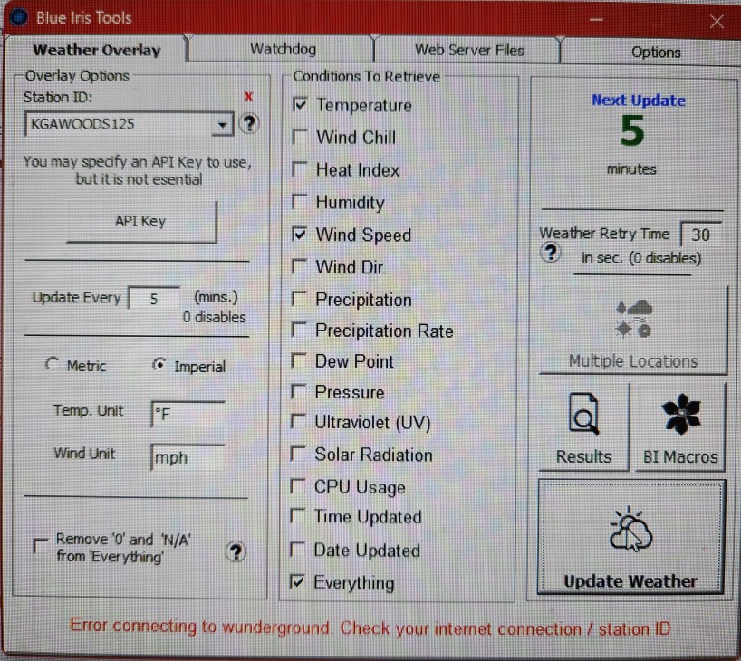

I can't get any weather station ID to work in BI Tools. All of them work fine on the Weather Underground web site. Anyone else having that issue? Any ideas on how to fix?

@TonyR : It worked up until about 4 days ago. I have made no changes. Weather does not change in the txt files, so it is always the same in camera view. Regardless of what Station ID I put in, I get "Error Connecting to wunderground. Check your internet connection / station ID."
** Correction **
I'm an idiot. When I put the station ID in all uppercase, it works. However, I was confused because the Station ID I was using was in all Upper case, so I guess something is wrong with that station. When I tried other stations, I left them in lowercase and none worked. When I tried another station in all upper case it worked.
Thanks!

curious if Wunderground is/has been up and running for you BIris users (specifically this last week)? my laptop crashed, rebuilt/settings held.. but i'm getting the " Error connecting to wndgrnd, chck INT conn / station ID.
any assistance would b appreciated.
I've tried 4 station id's in my area AS WELL AS those shown here in forum/thread.. and i get the same error/unable to update.
Ty in advance,
It currently is working for me, and I haven't seen any issues for a long long time, literally years I think.

TY for quick reply/confirmation.. i just tried your station Id.. immediately tries to connect (blue font change/flash too fast to read) then, red font/states error above.

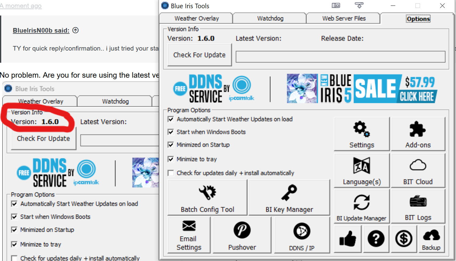

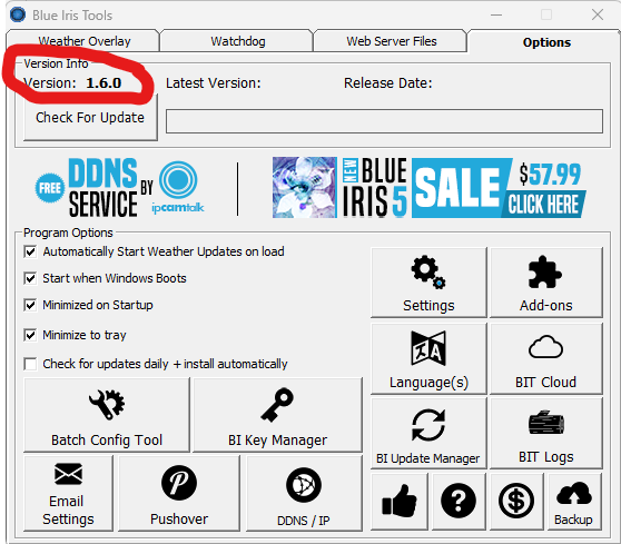

No problem. Are you for sure using the latest version 1.6.0 and didn't grab an old copy from somewhere?
AMP
Apr 15, 2015
56
46
Covington, KY
Also, I saw some one above in this thread mention that the station ID is case sensitive. It won't work in lowercase, you must use uppercase. I just tested, and I can confirm that is true, it must all be uppercase.
Sep 19, 2022
7
3
jus confirmed/same version as you... did fresh install of BIT and BIris 5 (5.2.9.7/version i've used for yrs/since 1yr lapsed..no issue until lappy crash/reinstall of all ,this last week.. with no connection/station id error/yet to get successful update)
