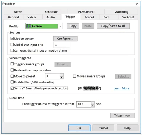

Welcome to the Sentry forum. Let me start by explaining the first step in our BI integration.
This feature is enabled on the Trigger tab in camera properties. You have to enable the feature on a per camera basis.
When enabled, the camera will still record when triggered. If humans are detected in the clip associated with the trigger, Sentry adds icons to the clip list as seen below:
The clips are marked with two icons. The Sentry logo marks a clip where human activity was first detected. If Sentry determines the alert is a continuation of a previous alert, you will see an "occupied" logo (a person) appear instead. For example, if the kids are playing in the front lawn, Sentry will mark the first alert with the Sentry logo. However, Sentry may identify subsequent motion alerts from BI as a continuation of the first alert (where kids were playing) and therefore mark this activity with the red human icon.
If you have SMS and/or email alerts set up for Sentry cameras... then you will now ONLY receive alerts associated with clips with the Sentry logo, i.e. new human activity events. Internally, our mantra is "Stop the nonsense". We hope to reduce false alerts and deliver meaningful alerts. Hope we improve your day by delivering alerts that matter.
All for now. More to come. Feedback welcome! :)

Not sure how you figure that? Does sentry only allow you to use BI pushalerts after it detects a human?
Where do you set your output or alert coming from sentry after it detects a human? I see under trigger you have a check box to use Sentry input, but where is the output?
That level of control is not in the product. We integrated Sentry alerts into SMS and Email alerts, i.e. when a clip is identified as a new event with human detection, i.e. "sentry logo" in clip, we send email and SMS alerts. Otherwise alerts are suppressed.
We will use the same logic on push notifications.
-- Sam from Sentry
