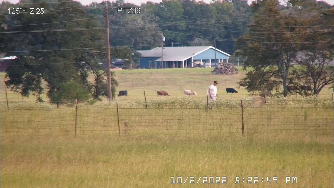

Here is an example of an old SD49225XA-HNR. 350 yards tracking. The Blue house in the distance is not quite a mile at 5200 ft. Forget about night time. Quality it tuned down for storage. That tree that in the way has another camera nestled within the branches. I have had no issues whatsoever with EmpireTech-Andy cameras.
