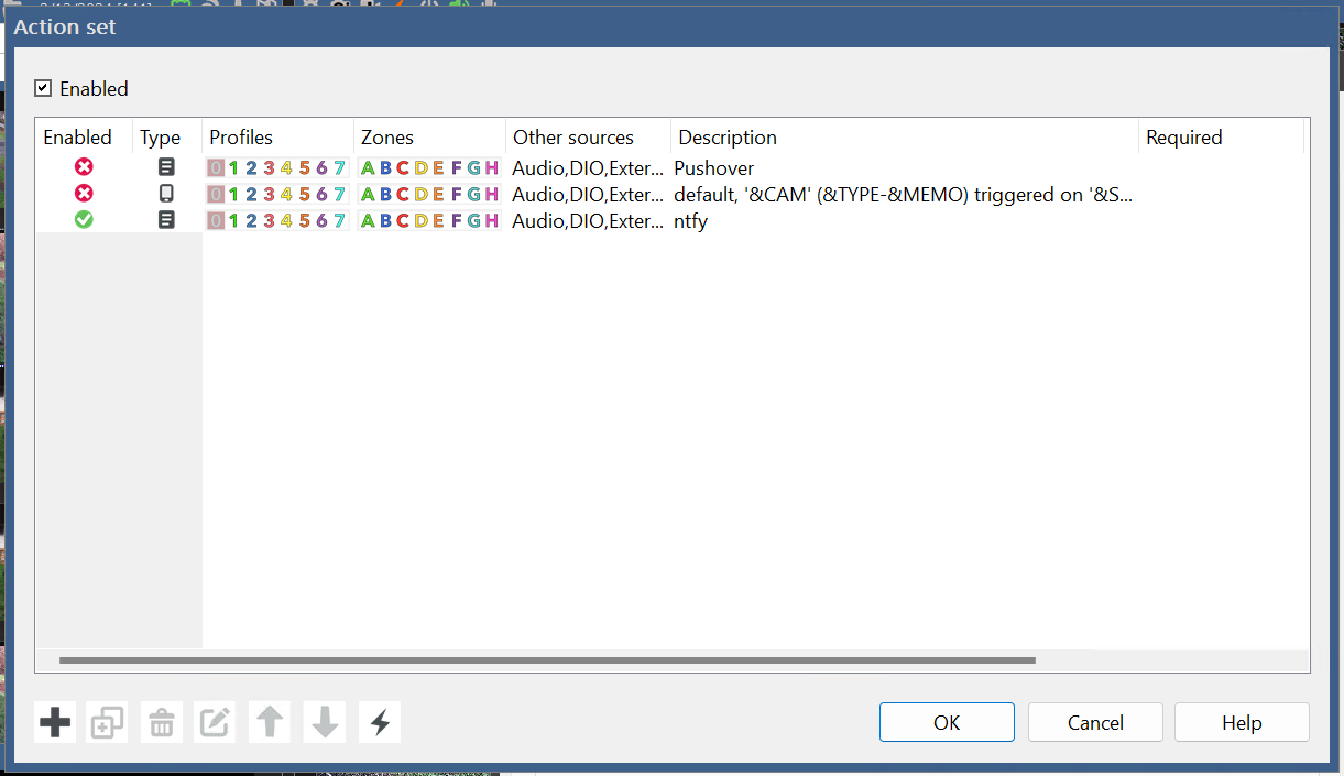

I've been using Pushover for quite some time and have been happy with it, but recently I've been looking to deGoogle my life. Since Pushover requires Google push on Android I'm looking for an alternative. What I have started playing with is ntfy, pronounced "notify". It is open source, can be self hosted if desired, and in some ways it works similarly to Pushover without the need for Google or Apple push services. One similarity is that messages can be sent using curl, but the syntax is different.
To send the word "Hi" to a phone the syntax is:
curl -d "Hi" ntfy.sh/MyChosenTopic
To send a photo use:
curl -T MyPhoto.jpg ntfy.sh/MyChosenTopic
The point is that at first glance the similarity with Pushover suggests that it can be used as a replacement, but before digging into the programming I would like to know if someone else has already put in the time to make it work with BI.
Some reference material can be found here.
Sending messages - ntfy

I messed around with ntfy a bit today and was able to get it to send BI alert images. Not all the stuff that the Pushover config sends, but just images is enough for now while I test speed and reliability. The other stuff can come later. The ntfy website shows paid plans, but you can use it for free.
