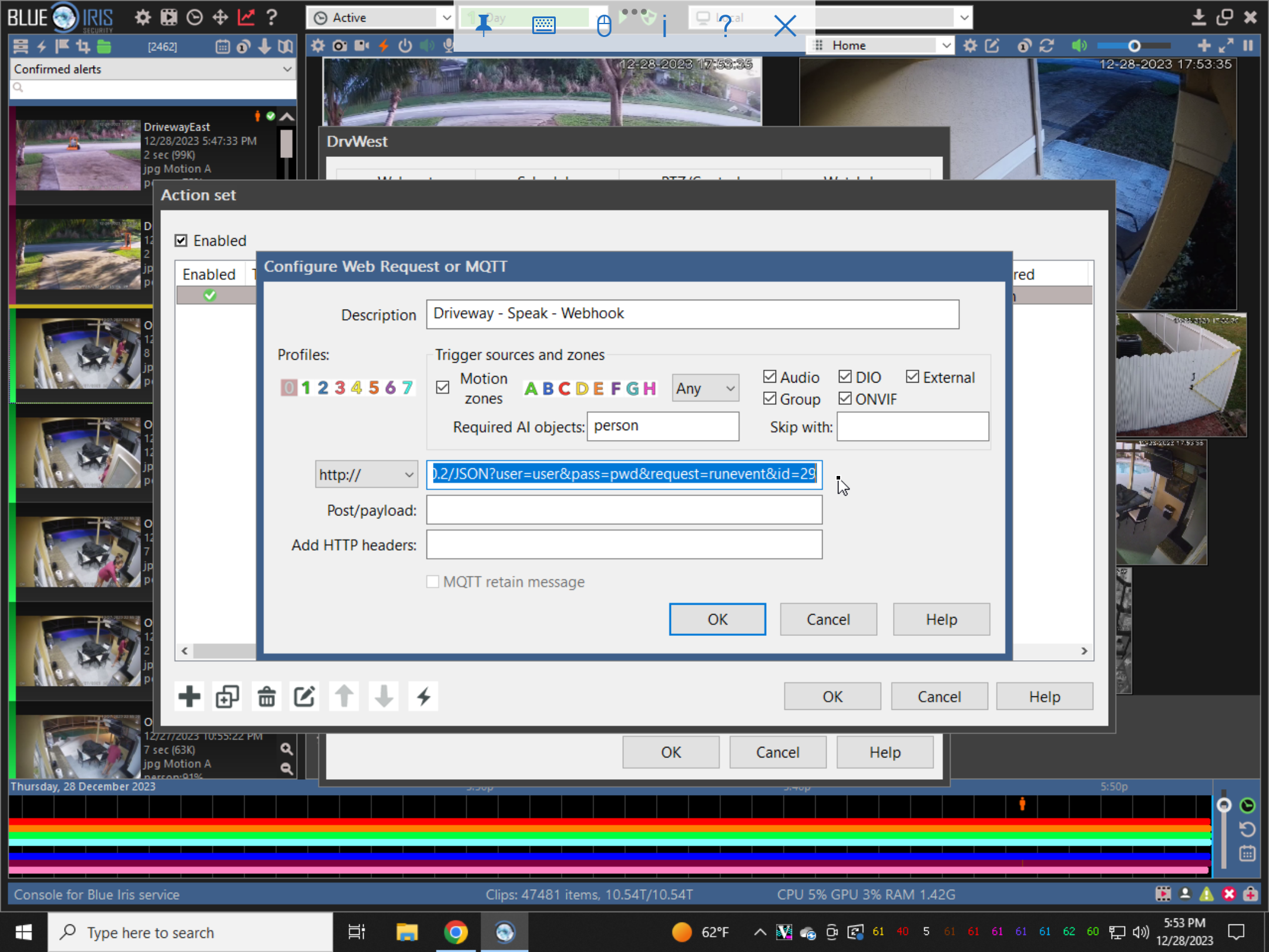

Here is an example of two events to Speak “Driveway” if a person is identified by a camera facing the driveway. The first event is called by BI in Alert/Web request or MQTT. I am using Web request.
192.168.0.2/JSON?user=user&pass=pwd&request=runevent&id=29 Substitute your HS user and password as indicated.
My HS4 computer is at 192.168.0.2 and the first event writes its event ID in the log so I can include this ID in the Webhook from BI.
You could add any conditions you want in the second event to prevent it or allow it to run.
