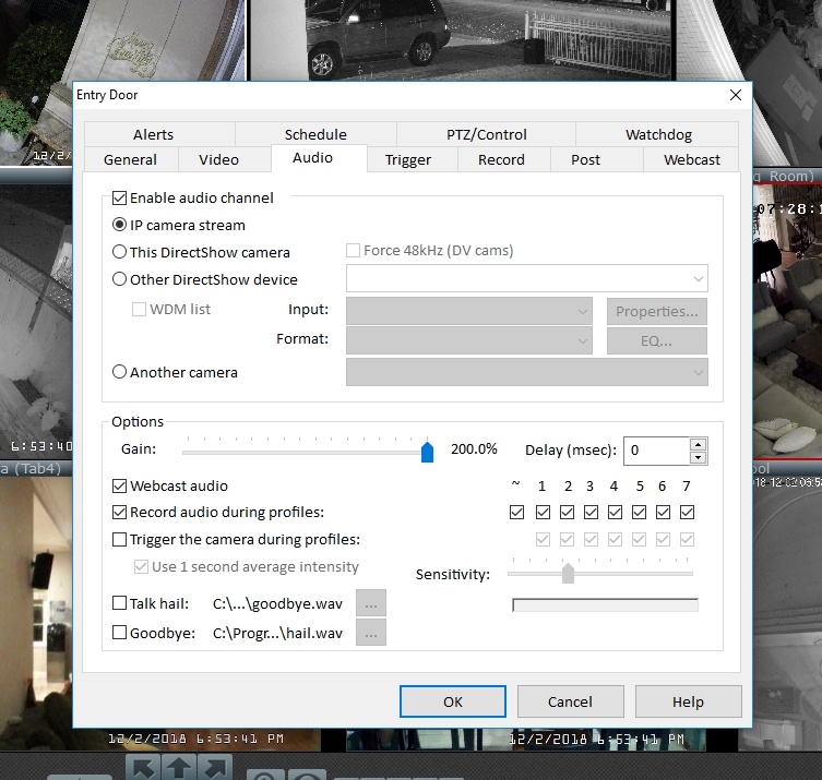

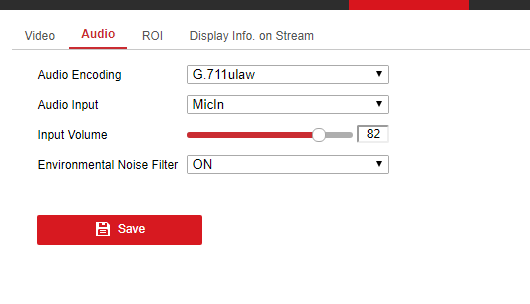

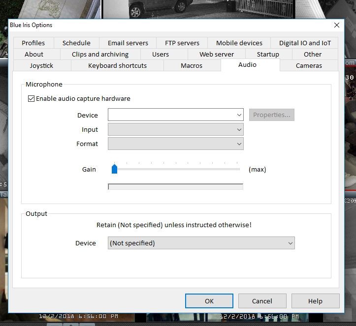

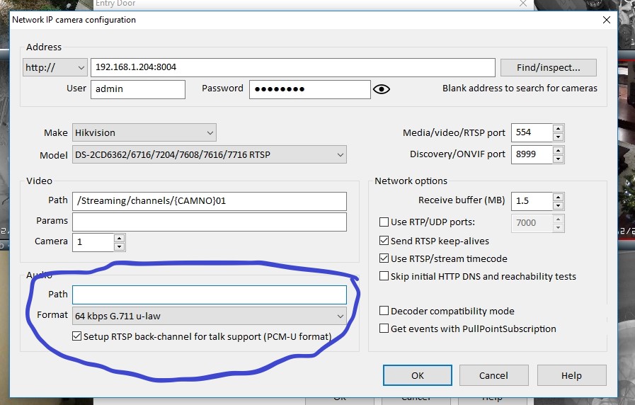

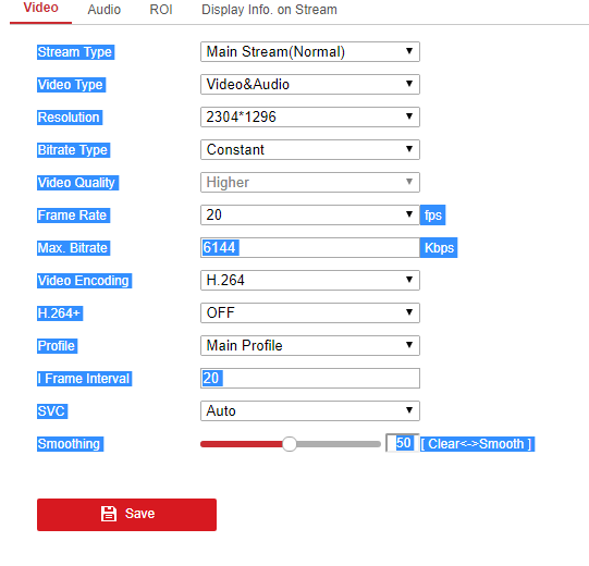

in the video configuration, try using hivision 2cd or hikvision rtsp, it wont work with onvif/find inspect. also post the camera web interface video settings and blue iris camera properties audio tab in blue iris as well as blue iris options audio

you have not posted the images requested.
