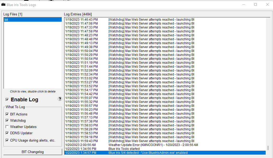

Good morning,
Noticed that my windchill and temp haven't updated in a while so checked on BIT - sure enough, it's 'Error connecting to wunderground' - no issues with internet and no changes to firewall etc - it's just not connecting. Tried other API keys (known working ones) and nada.
Anyone else?

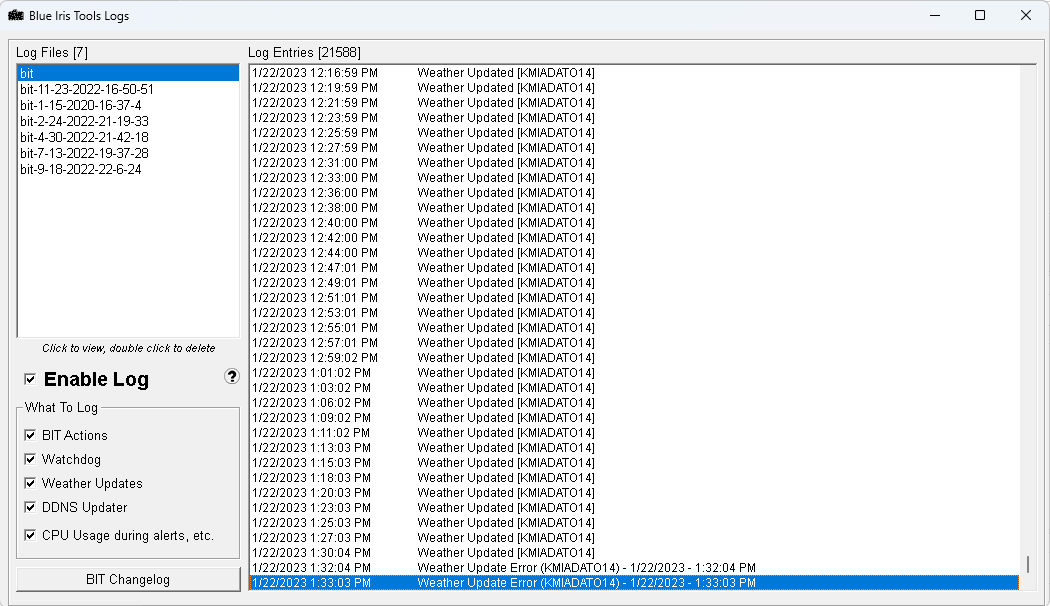

Well I'll be damned. I believe that this may be a case of Schrödinger's BIT - 1:32 was when I connected back to my RDP session... Maybe it only dies when you look directly AT the BIT... :banghead: - it also started working after disconnecting from the session earlier...
Kinda wish I could enable debug logging.
Edit: Spoke too soon - while it says that it updated, the temps reporting are not what the station in question is reporting - so it's not accurately pulling anything at this point.
