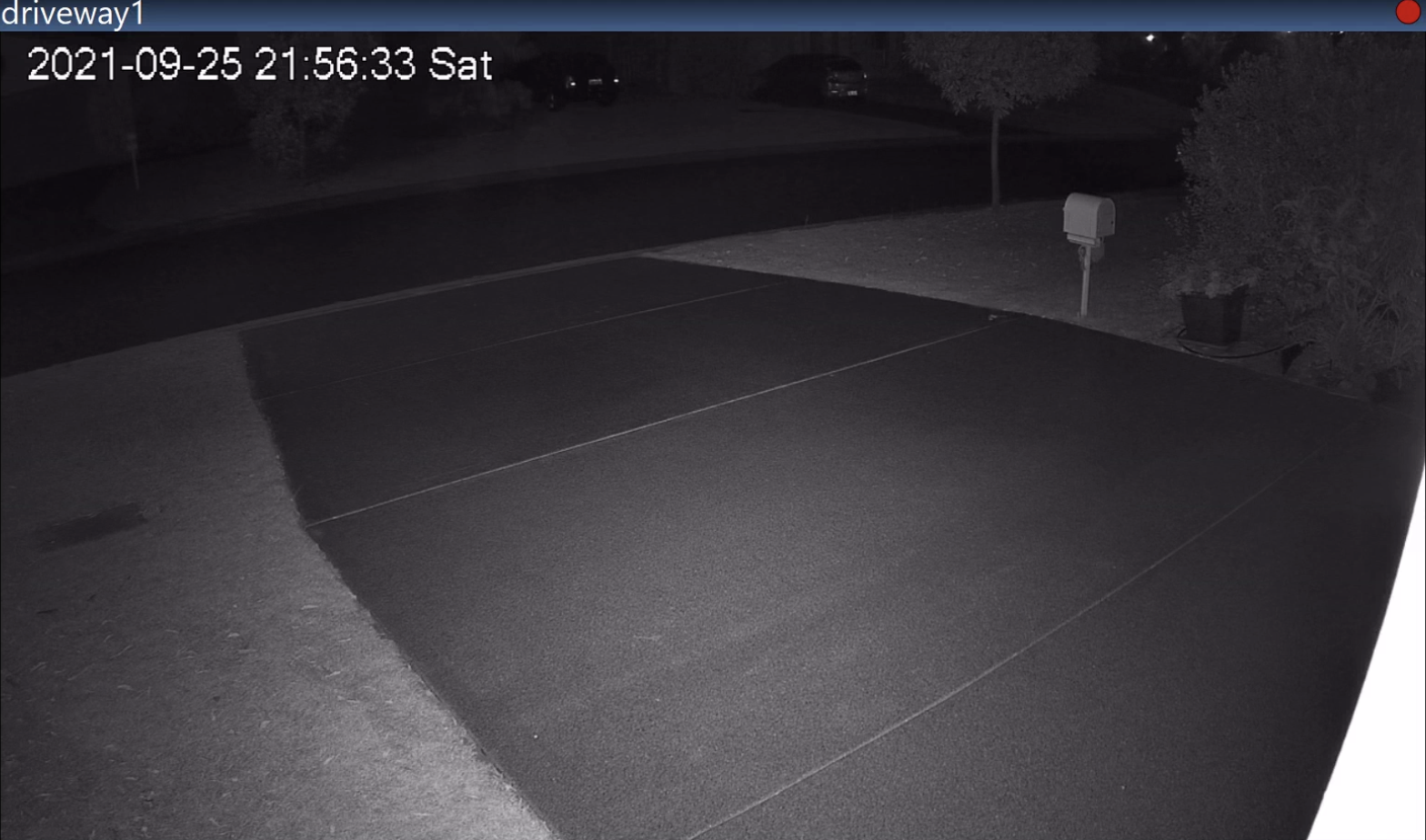

I have a camera pointing at my driveway, towards the road. It would trigger BI when cars were passing through, but when people were walking on the road, it won't trigger BI. I am guessing this may be because "Min Object Size" is too big? Is there a way to set different "Min object size" for different areas of the screen, so that it is set to small for distant objects, and bigger for areas closer to the camera?
Or perhaps because there isn't enough contrast at night whereas cars' headlights would provide that contrast to trigger BI motion?
This is the view:

My answer to your other post regarding the "objects" triggering your cam could solve the above as well. In other words, you need more illumination, IMO.
I'd disable the cam's IR and install an appropriate (beam width/depth and output) outboard emitter to throw some light on that driveway and toward the road.
Once in place, tweak the motion detection settings.

In any event, objects on the edges can be problematic for some fields of view. You can see the IR is pointing right at your driveway.
One camera cannot be the see all/do all, so if you really want the street, you need a varifocal pointed that way.

Properly "tune" the camera for the field of view. You need to take the camera off of factory defaults and set it up using the manual adjustments. Common issues with camera image | IP Cam Talk
Use the AI in that camera, it will work much more reliably then then BI motion, with lots less false alerts.
Tilt the camera up just a tad, this also raise's the IR illumination and improves it's throw.
Bottom right corner of the picture, you are experiencing IR glare from something (white area) change the zoom of the camera or adjust the FOV so you don't have the IR bounce, it is affecting your camera's exposure.
With some adjustments, you can improve that view quit a bit.

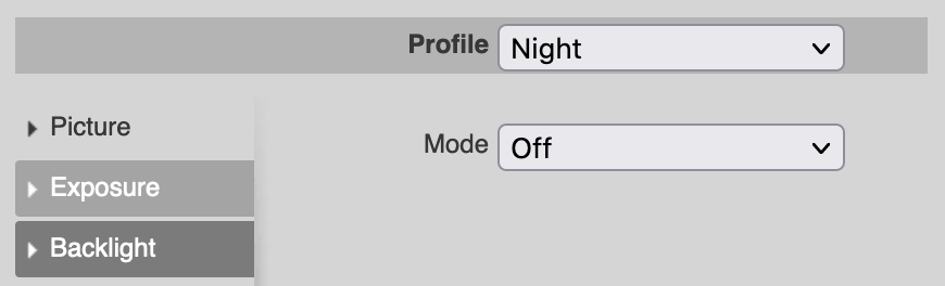

I set the profile on the camera to "Day/Night", which I assume would auto switch the profile based on light level? I would like to explore perhaps writing a script that will set the profile of the camera based on sun elevation. I just need to find out how to switch the profile of the camera remotely. However, it isn't the cause of this particular issue.

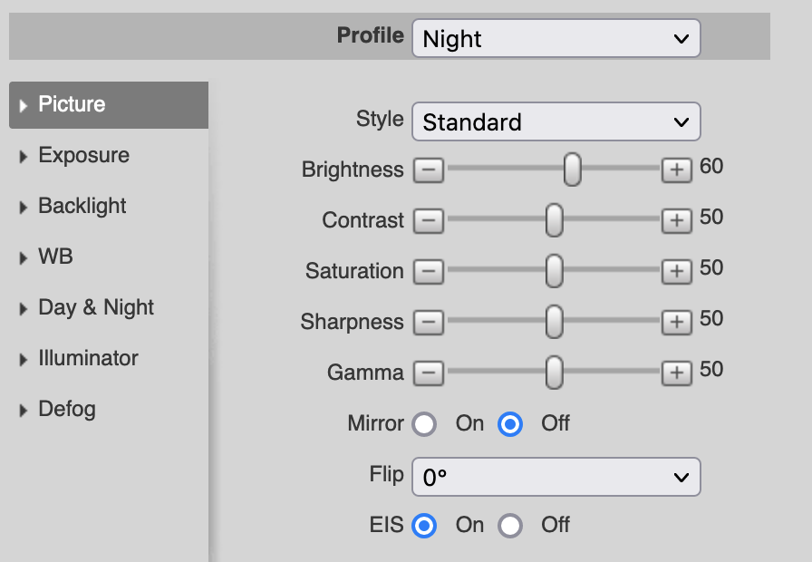

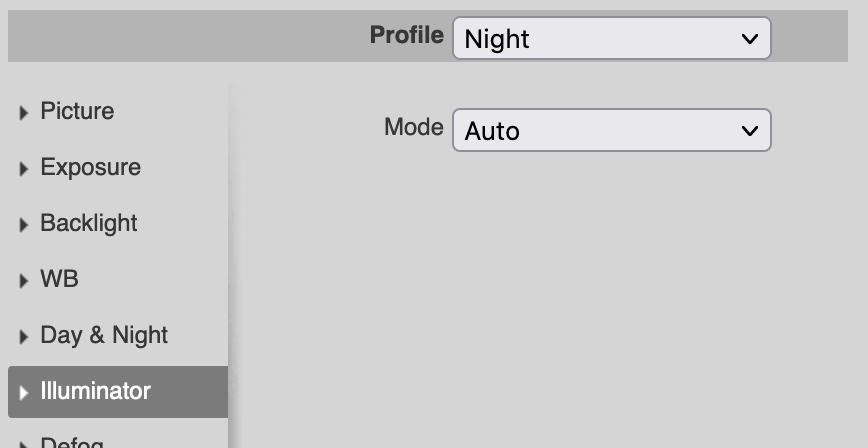

These are my settings:
Backlight: OFF
Illuminator: Auto
Defog: OFF
I'll play with the camera angle tonight. I pointed it down so it can see more of the bottom left area though. And it's hard to remove the bottom right pillar without losing most of the driveway close to the house.

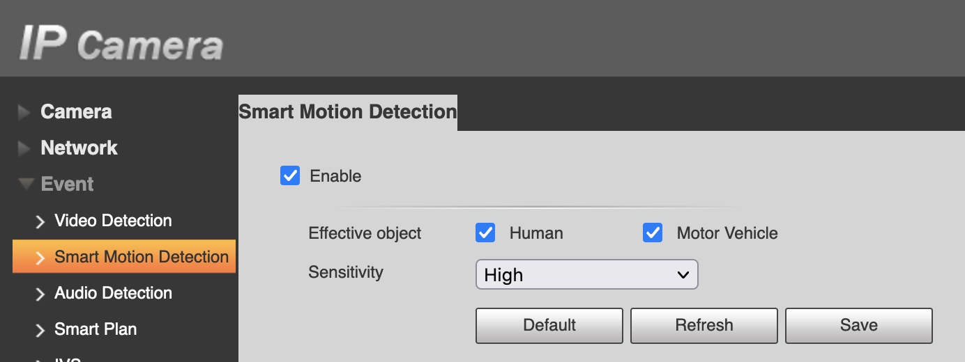

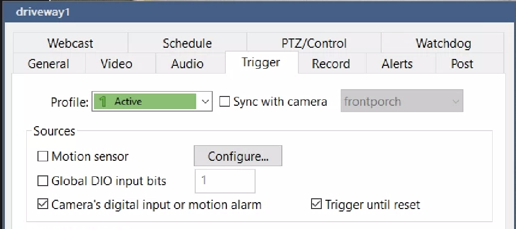

I've just tried enabling "Motion Detection" and setting up zones. I've also enabled "Smart Motion Detection" for "Human" and "Motor Vehicle".
In BlueIris camera trigger: deactivate "Motion Sensor" and enable "Camera's digital input or motion alarm"
Then a car just happened to drive by but BlueIris wasn't triggered. Can BlueIris use the camera's motion detection for its trigger?

Don't use Smart Motion Detection and try IVS rules instead.
Then you need to go back into BI and go to the camera setting and select the "pull onvif triggers" box and then re-hit the find/inspect so that BI is pulling those settings.

Thanks! Bingo: onvif triggers!

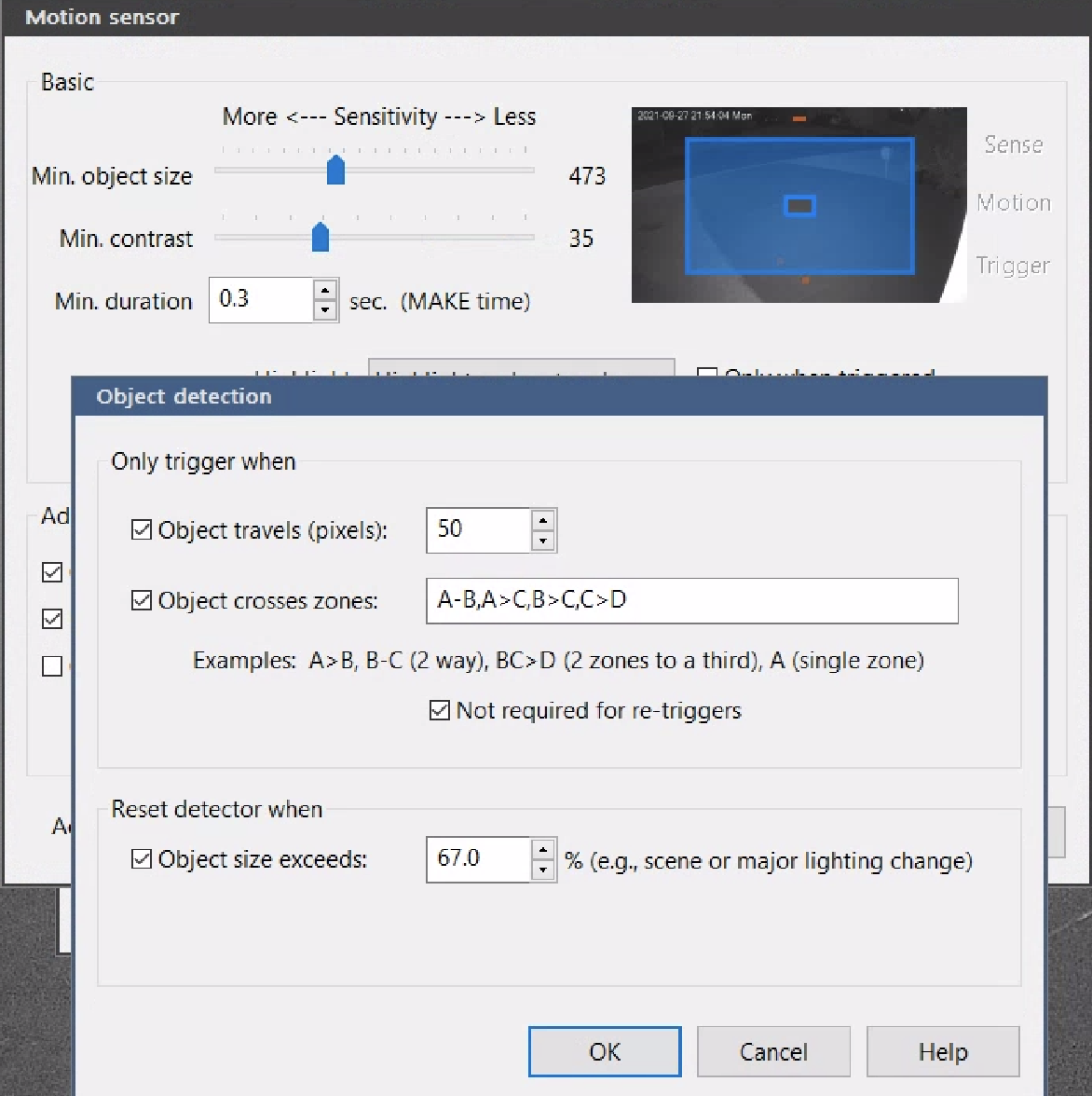

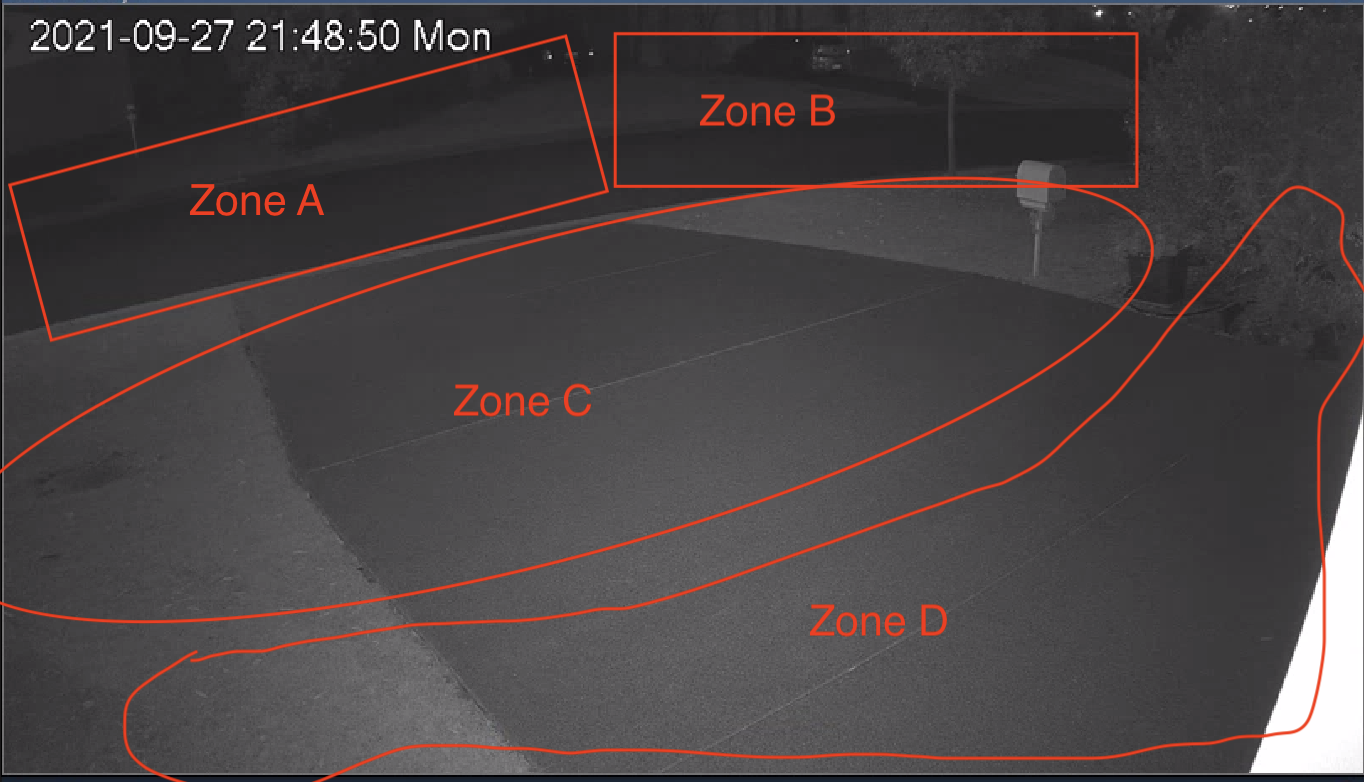

I have turned off the camera IVS and going back to BlueIris' motion detection. I have set up Zone A and B, so that Zone A covers half of the road, and Zone B covers the other half of the road. I've also set up Zone C for the end of my driveway and Zone D for the inside of the driveway, so that I can detect C>D indicating something is coming towards the house.
then I set up "Object Detection" "Object Crosses Zone" as follows:
So far, this will detect cars going up and down the road, but even during daylight / good light, it didn't trigger/alert on:
  • Fast moving cars
  • People in bicycles
  • Pedestrians
My dahua cam main stream is 4MP, h265 CBR 8192bps, 15fps, iframe: 15
2nd substream: h265 1280x720 (720p), CBR 2048bps, 15fps, iframe: 15
What should I adjust in order to get the trigger working for the fast cars, bicycles, pedestrian?

Try turning off the object travels so many pixels and turn off reset detector. Both of those are used to eliminate false triggers and you have the opposite going on.
Min object size probably needs to be smaller to get people in the street.
I would make the min contrast a lot lower also - trying to get people out in the street is beyond the "sweet spot" of the camera field of view and infrared, so it will struggle out there.
I'd suggest setting up IVS for Zone C or D and let the camera AI IVS notify BI (and you) if there is motion in that area).
After making your suggested adjustments, the trigger now works on pedestrians, bicyclists, etc. Thank you!
