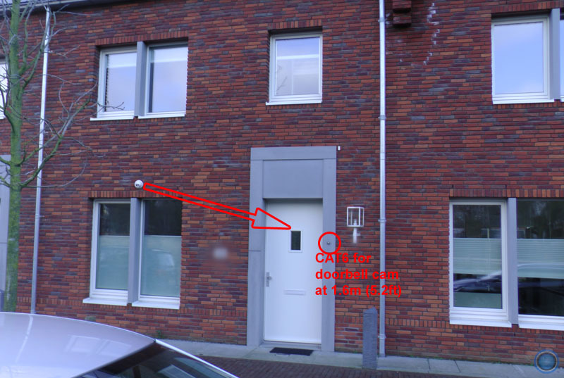

Hi,
I'll be ordering some outdoor camera's for our home that's currently being built and I find myself wondering whether I should be getting white or black camera's. They will probably be Dahua 2MP starlights turrets or eyeballs.
To get an idea of how this would look on our new home I made some pictures of an someone else's existing home nearby which was built using the exact same materials, bricks etc. This particular home has a white security 'bald spot' cam (again, this is not my home and I will not be placing the cams like this).

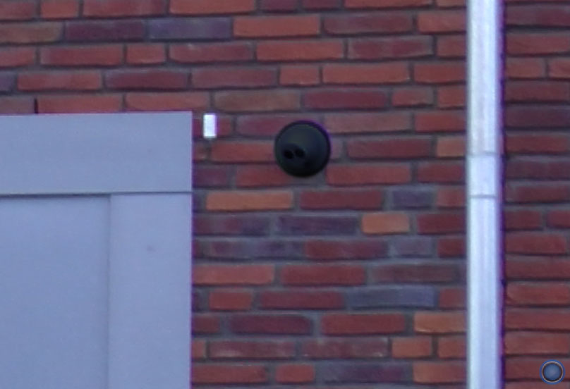

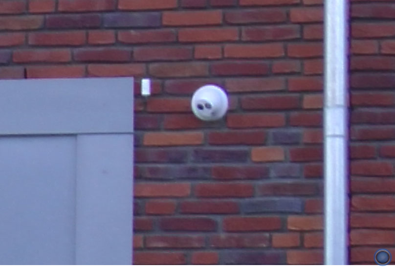

I used PhotoShop to attempt to find out what a black cam would look like, so here's both versions:
And some close-ups:
There are various considerations involved such as do I want my cams to be inconspicuous or not, although in my case I'll probably be required to put up a (small) sign that advertises that there are security cams anyway.
What would you do and why?

  • I commend your choice of using the Dahua 2MP Starlight turrets.
  • I'd go with white...that additional chance of visibility by contrasting with the brick could be a deterrent in itself.
  • I'm estimating that the cam as shown is at 9 ft. height (7 ft. door + 12 rows of bricks); if so, that's too high....7 ft. would be better if at all possible.

Thank you for chiming in, appreciated.
As for camera height, I already dubbed the cam on this house a 'bald spot' cam in my OP as it's too high and too close to cover the door area. On our house the front door cam will be placed just above the lower floor windows, in addition to (hopefully) a doorbell cam and the doorbell and lamp will be on the other side of the door:
I'm hoping this will make it more useful.
So the doorbell "cam" will be at 5.2 ft. but the actual doorbell button will be below that, at about doorknob height?
No, both will be at 5.2 ft. The standard height for the doorbell is indeed at about doorknob height as per the pictures in my OP but in my case the doorbell has been moved up to 5.2 ft and the standard wiring has been replaced with CAT6 with 15cm slack in the wiring so that I can the standard doorbell with a doorbell cam at my convenience after building is completed. I also prefer the doorbell a bit higher than doorknob height to keep pesky small children from pressing it :)
I'm hoping that a doorbell cam at 5.2ft will provide a good view on faces in most circumstances, even if someone is wearing a baseball cap.

Thanks. Now if only I could find the doorbell cam of my dreams (well, not literally), you know, the one that everyone wants: PoE, no cloud, 2MP, small and stylish with high WAF, Onvif, SIP audio support etc... at a price that won't break the bank.
That is the question really: do I want them to be highly visible or not? From a deterrence point of view the answer is of course yes. On the other hand I'm planning to also have an alarm system with an outdoor sirene/flashlight on the front facade. Would that perhaps provide sufficient deterrence by itself ?
Regarding the color of the cams, my only doubt has to do with esthetics and WAF and NAF (Neighbors Acceptance Factor). I kinda like how the black ones are not very noticeable but on the other hand even though the white ones are probably much more visible they might also come across a bit friendlier, if that makes any sense.
So, what do you think, do white cams look friendlier than black ones?
If you haven't done so, I'd check with local ordinances regarding exterior sirens.
Speaking of neighbors, again I'd insure local ordinances are OK with where the cams point, record, etc. as a privacy issue. It may be a simple matter of showing someone that it looks only at your front door, walkway, etc. Most people like their presence, a few do not....that's the one you may live next door to.
Careful now....let's not make this a racial issue.. JUST KIDDING! Also trying to inject a little humor, as lately here the U.S. some factions are "off the rails" when it comes to collectively "having a chip on their shoulder" along with being too thin-skinned. IOW, too many folks are looking for an excuse to criticize every action or statement as having some sort of hidden meaning or dubious agenda.
I still like the white. Now if I had a dark brown soffit, fascia and gutters, I'd custom-paint them to match, especially if mounted under the soffit/overhang/eave.

As for the color; I would choose black; it looks much neater that way; you don't have a white pimple on your wall.

So that's:
  • 1 vote for white
  • 2 votes for black
  • 1 vote for brick-colored
Still not sure what I'm going to do. More votes please :)
I wonder if I'm going to need a mounting bracket 'base' to mount it on and if that comes in black as well or if I can screw something like the 5231 straight to the wall.
