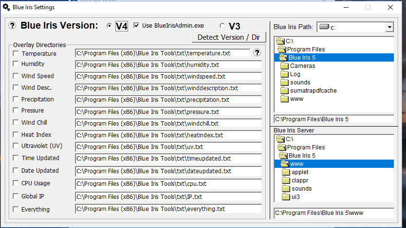

I am almost done integrating BI5 with BIT. In the meantime you can manually set the directories of BI5 in BIT -> Settings then Blue Iris Path and Blue Iris Server. Set those to whatever version of BI you are using.

I have gone to BIT->Settings and set the directories to BI5 but when I try to enable BIT it gives me Error#0 right away and then disables the watchdog. Any idea what I'm doing wrong?

Can you try restarting BIT / the computer?
I had tried just restarting BIT before but I guess I never tried restarting the computer! That fixed it! Thank you! Any idea when the update will be coming out? Really appreciate all the work you’ve done with BIT!
