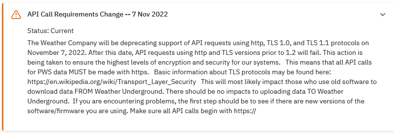

For tides: I can run the following API and get the results as shown. Dates are collapsed for both readability and to hide identifying info. Next step is to figure out how to 1) get the query to execute on intervals and 2) parse the results for display on the overlay.
I'd like to display the next high and low tide times.
Code:
http://api.wunderground.com/api/[xxxx]/tide/q/pws:[yyyy].json

Is there a chance that BI Tools can be updated to have the ability to use open-metro.com weather? I have tried setting up the script Chris posted but I cannot get the task scheduler to re-run the script every 15 minutes. It will run once even though it's set to repeat. Updates the first run and that's it.
currently BI tools will update the weather from WU for a few days then it stops and I have to remote into the BI PC and force it to manually update the weather. Then it again works for a few more days till I have to do it again!

Alcon, I've been following this forum topic for a few years with no real resolve, it appears that the owner of BI Tools has abandoned his app. I've seen no real update/improvement of a great tools for BI in particular Weather Overlay handling.
I too was able to get my BI Tool to work again recently but this seems to be fluke until it doesn't work with Weather Underground... so with that said I found a way with help of others to create the same results with; a Powershell script, a simple bat file, and Windows scheduler that runs the bat file at which ever frequency of your choice. If anyone is interested let me know and I will provide the steps and associated script.
