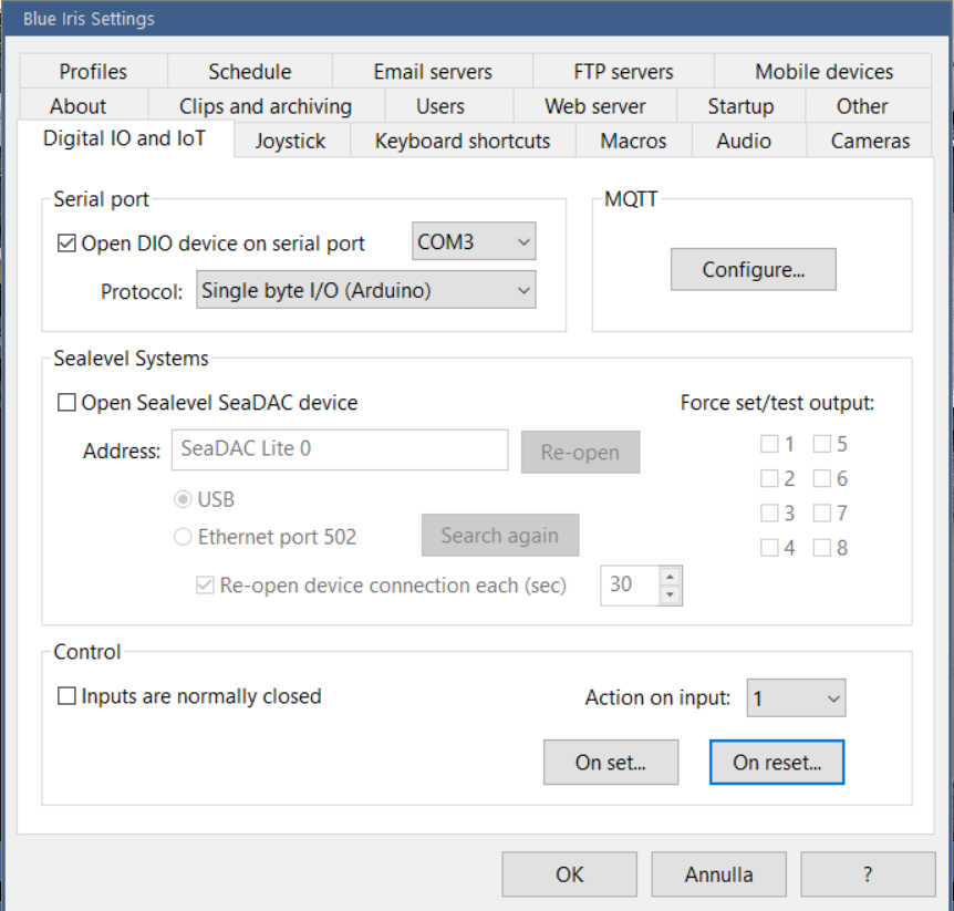

Hello to all ! Using an ESP8266 i made a presence detector that send 1 over serial port if one of the family cellular is detect and send 0 otherwise.
It's possible to use this logic to enable camera alerts only if blue iris detect 0 on the serial port ?

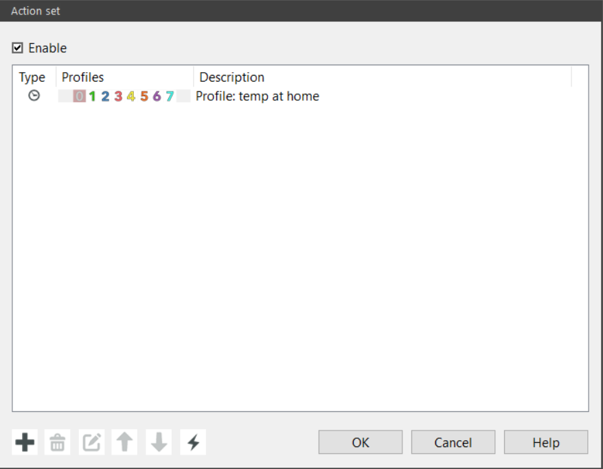

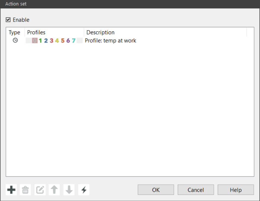

However I found the solution to my problem. I made two profiles, one called at work with alerts enabled and one called at home with alerts disabled. In the Blue Iris Settings->Digital IO and Iot I used the control parameters On set and On reset setting the necessary rules to switch between the two.
