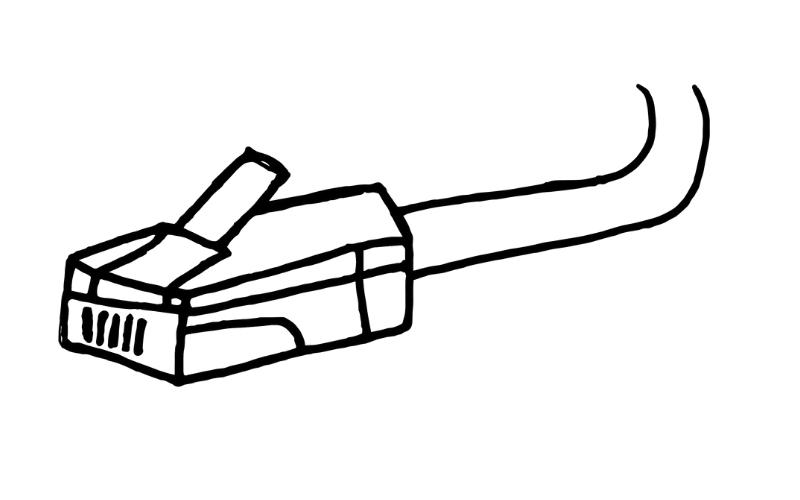

Regarding all types of outdoor-rated Ethernet cable, but particularly shielded, I have found it makes insertion of the prepared cable into the RJ-45 male connector a lot easier by taking the flat, un-checkered part of my flat-nosed or needle-nosed pliers and slightly flattening the end of the outer cable jacket about 1/2" where the jacket ends and the 4 pair colors are exposed; this makes it so much easier to insert the cable into the connector and under the piece that is designed the grip the overall cable jacket, taking some mechanical stress off of the gold-plated, insulation displacement crimps that bite into the individual conductors.
Whew! That's a lot of wording to explain what I mean but I think I got it across. As they say, a picture is worth....you know:
