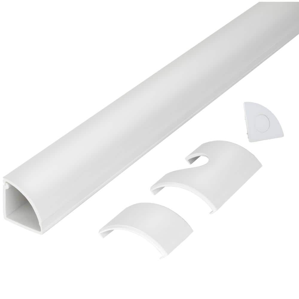

Unless you have a stapler designed specifically for low voltage wiring I'd avoid staples. Stick-on wire duct is cheap, easy to work with and can be painted to match. This one is for baseboard use but they also have rectangular stuff as well.
