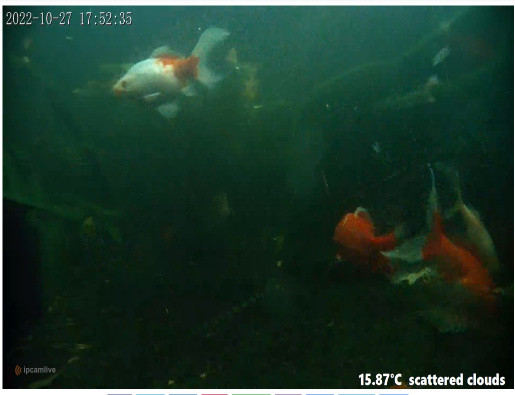

In addition to cameras for security I use Blue Iris to provide a web cam feed for an underwater pond cam "www.pondwatch.uk" . At night when it is dark instead of disabling the camera which makes people think its down I would like to display an overlay that says the fish are sleeping please come back in daylight hours. For info IR illumination doesn't work very well underwater.

Try this... a fully self-contained Blue Iris solution.
(it's not really as complicated as it may first appear.)
1. Create a text file to hold your overlay message... e.g. "C:\Blue Iris\My Overlays\FishPondMsg.txt".
2. In the Settings>Macros tab, edit any macro (e.g., %9) and point it to the text file in step #1... e.g. "file:/C:\Blue Iris\My Overlays\FishPondMsg.txt".
3. In the cam's 'Video' tab, add an overlay pointing to the Blue Iris macro assigned in step #2 (e.g., %9).
4. In the cam's 'PTZ/Control' tab, click 'Edit presets' and create two presets that perform a 'Write to file--replace' action.
The 1st (e.g., #39) should write nothing (a blank 'Parameters' field) to the file in step #1 ... Note: for testing have it write "(Enjoy!)" so you can see that it is working.
The 2nd (e.g., #40) should write a 'Parameters' string like "(Daytime Only)" to the file in step #1.
5. In the cam's 'Schedule' tab, click 'Events schedule' and add two events:
The 1st should be a sunrise action, with a PTZ Preset function pointing to the 1st preset assigned in step #4 (e.g., #39).
The 2nd should be a sunset action, with a PTZ Preset function pointing to the 2nd preset assigned in step #4 (e.g., #40).
Once you get it working, adjust the suntime offsets to your liking.
If for some reason you ever want to turn off the overlay message, or display a permanent one (e.g., "Under Maintenance"), simply disable the Events schedule and manually edit the *.txt file appropriately.
