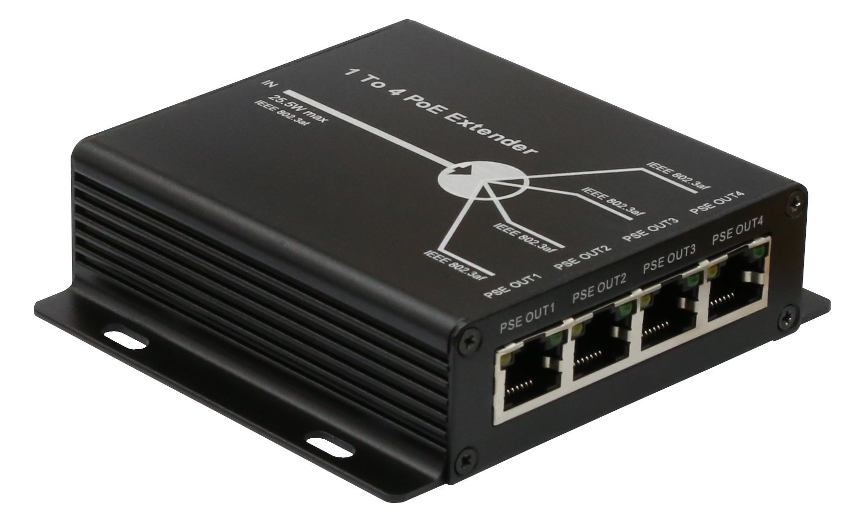

for more than 2 cams at the end, consider: Amazon.com: OdiySurveil(TM) 4-Port 10/100M IEEE802.3at (Power-in) to IEEE802.3af (Power-Out) PoE Extender for Ethernet/PoE Power: Industrial & Scientific
can power up to 4 PoE devices, up to 25w total power, which may or may not be adequate, depending on the cams...

The 1 to 4 POE Extender is sold under a variety of brand names. They all seem to have the same specification. You connect a single POE+ cable carrying 25w, and it splits that into the 4 ports running a maximum of 24w between the 4 ports. So in this case, where I connected only 2 cameras each drawing less than 8w, they performed perfectly. I did not try to add a 3rd camera with another 8w, but since that would be at the outer limit of the outbound power budget, I would be concerned about possible problems. My sense is so long as one stays within the outbound power budget, this should work well.

The 1 to 4 POE Extender is $39.

Similarly, the 1 to 4 POE Extender seems like a straight-forward solution for adding an additional camera or other accessories, while keeping within the outbound power budget limitations. If outdoors, it will need to be located or housed in a weatherproofed location.
