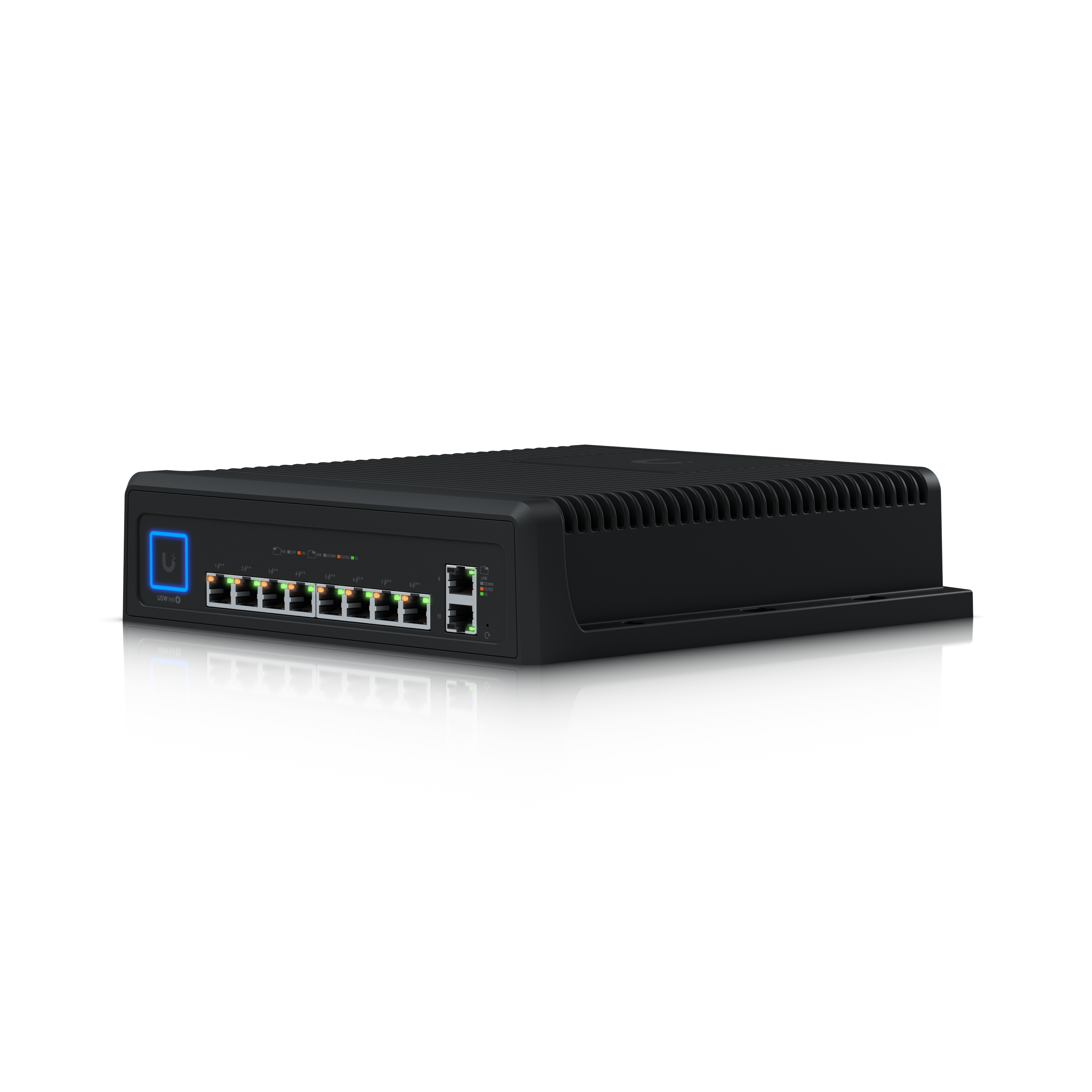

This isn't a BI question per se, but that's what I use for all three of my cams (power use lol) — hopefully soon to be four — and couldn't think of anywhere else to ask this. So — I have a hardware/power issue.
The short of it is: Two of the three cameras (and if possible, three or four of four) are mounted in the front of the house/porch area, where the is no AC access. I have to run the ethernet cable from the basement along the outside of the house where the A/C is. For various reasons, I'm limited to one cable. So, I have the switch, injectors (no PoE router/switch, just a regular ubiquitous blue metal 4-port Netgear) in the basement, and pair of passive PoE splitters. This gets me two cams fine.
Is there any solution for more?
What I'm looking for/hope exists is a PoE-powered PoE switch that draws power from the switch in the basement. Does such a thing exist? If so, the passive splitters go, and now I have the ability add [x] (4-6, presumably) cams up front (there's a lot of street action around here, and not of the good kind) with short runs from this mythical switch. I also assume (know) that the Netgear (and individual injectors) would have to be replaced with an actual PoE switch — with one port that carries a significant bit of juice.
Is this possible? I've searched Amazon using the phrase PoE "power sourced" switch and get nada. Also, if possible, a general outlay of what such a switch will cost (and recommendations, if allowed by forum rules for a proper PoE router) would be appreciated.
Thanks in advance,
PD (Chris)

Look for a "PoE Extender" on Amazon. I can't give any recommendations on any of them that come up so good luck and you can always return it. Keep in mind that the total power is still limited to the limit of the original switch that supplies the power.

Thanks y'all... I think you solved my problem for $130:
Let me know if i'm missing something. Thanks again – Chris
