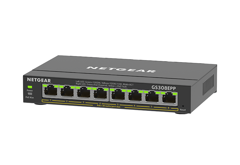

And another followup question; would the Netgear GS308EPP be adequate to drive 3, or 4 if we decide on one more later, cameras and potentially an IR light?
  • Total PoE+ Ports: 8
  • Total PoE+ Budget: 123W
  • Uninterrupted PoE: Yes
  • Bandwidth: 16Gbps
  • Max Mac Entries: 4K
  • Buffer Size: 192KB
  • Energy Efficient Ethernet (IEEE 802.3az): Yes
  • Priority Queuing: WRR
  • Jumbo Frame Support: 9,216 bytes
Or do you have any other suggestions for a similarly priced or cheaper switch?
