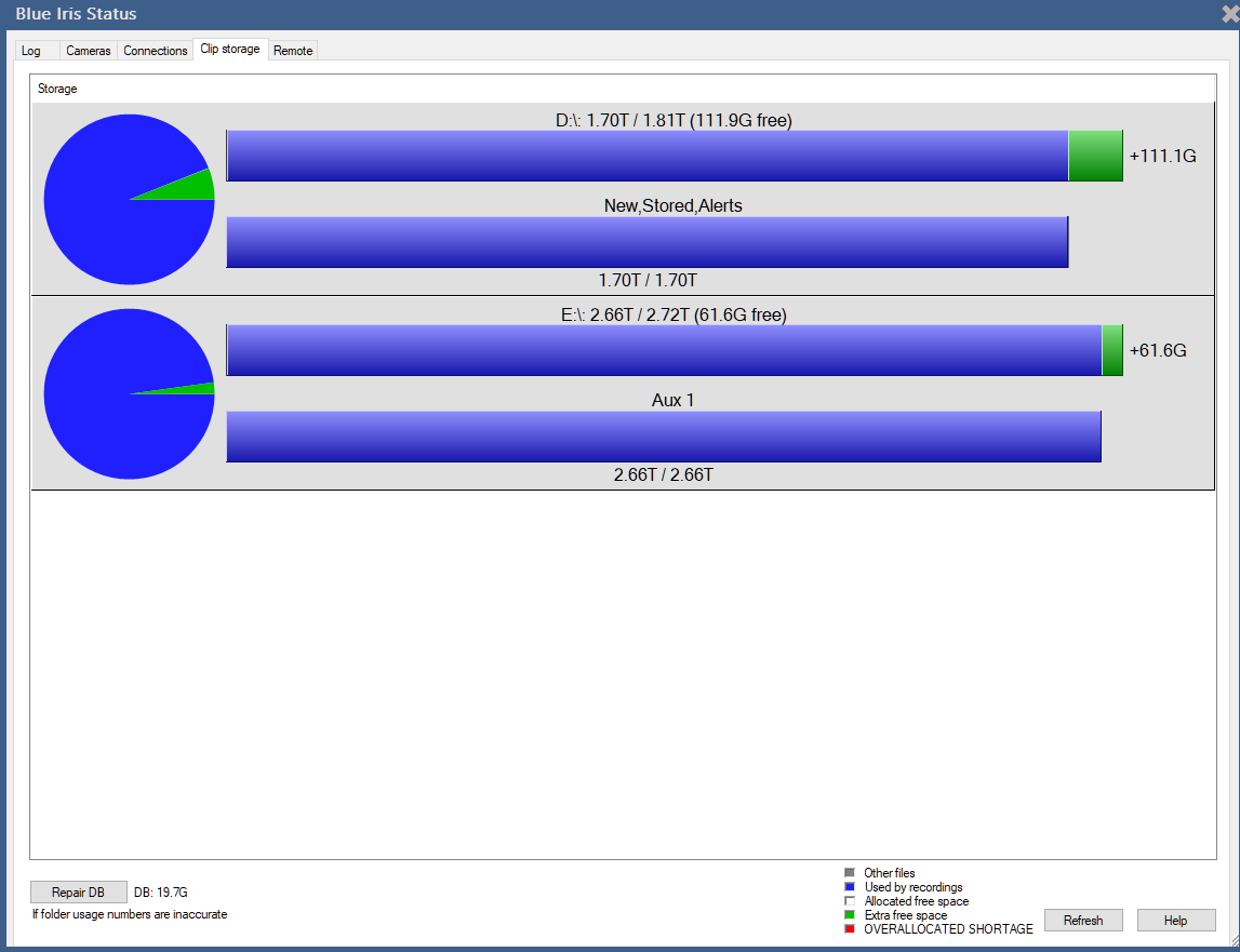

Go to Blue Iris Settings, Clips and archiving tab. There, you can select each of Blue Iris's "Folders" and choose which drive they go onto. Put your "New" folder on drive M and set the limit to about 7000 GB. Uncheck the clip age limit. Choose the "Delete" option from the radio buttons.
Then look in Blue Iris Status > Clip storage tab and see how much space it says you have free on drive M. Adjust your size limit as needed (back in BI settings > clips and archiving). I recommend at least 50 GB remain free, unallocated. That is the green "Extra free space" section on the charts. Some configurations may need more than 50 GB free, but recording only on motion, 50 GB should be plenty.
