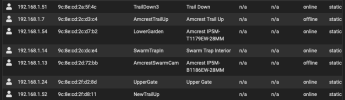

I have a Blue Iris server box behind a port forward (port 81 only) from my pfsense 2.60 appliance, on a "things" subnet of my segmented network, along with my IP cameras, smart TVs, etc. All cameras have DHCP reservations:
One camera in particular, TrailDown (MAC 9c:8e:cd:2a:5f:4c, reserved at 192.168.1.51), keeps disappearing from the BI feed:
and there are messages in the BI server's logs of Changed to IP 192.168.1.251 and then Changed to IP 192.168.1.51

Those other MAC addresses 9c:8e:cd:2f:d8:11, a0:bd:1d:c4:64:2d, etc. are/were all cameras on the same subnet, some of which are active on other reserved IPs and some of which were removed from the network ages ago.
