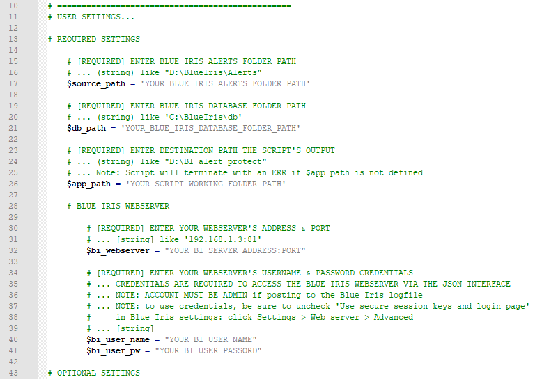

Edit the user settings file
  1. The user settings file is named 'BI_alert_protect_user_settings.ps1'
  2. Open the file in a text editor (a code text editor is recommended; I use Notepad++)
  3. Edit the REQUIRED SETTINGS section (see screenshot)
  4. Ignore the remaining settings for now. They provide customizations that you may want to explore later.

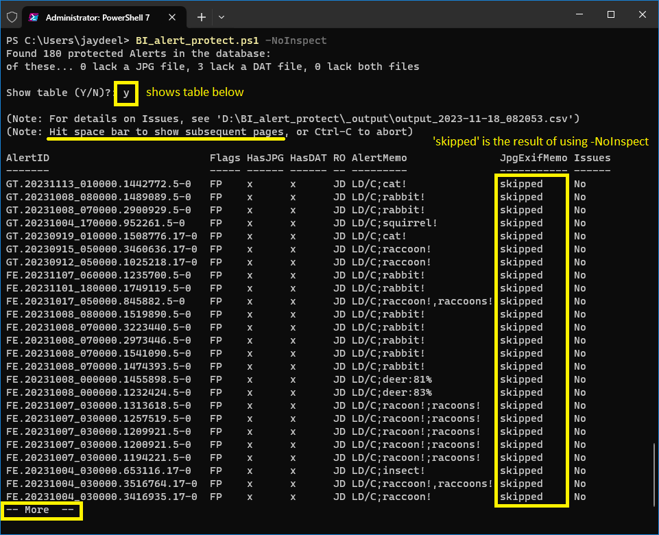

3.1 - Select and copy the following command and paste it into the console.
BI_alert_protect.ps1 -NoInspect
Hit the Enter key.
(Be patient, it may take awhile for the script to respond if you have a lot of Alerts.)

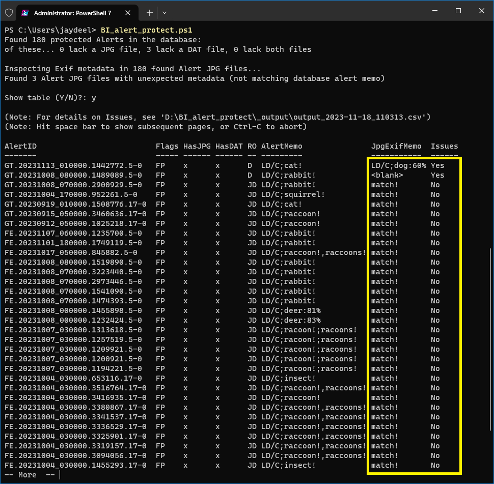

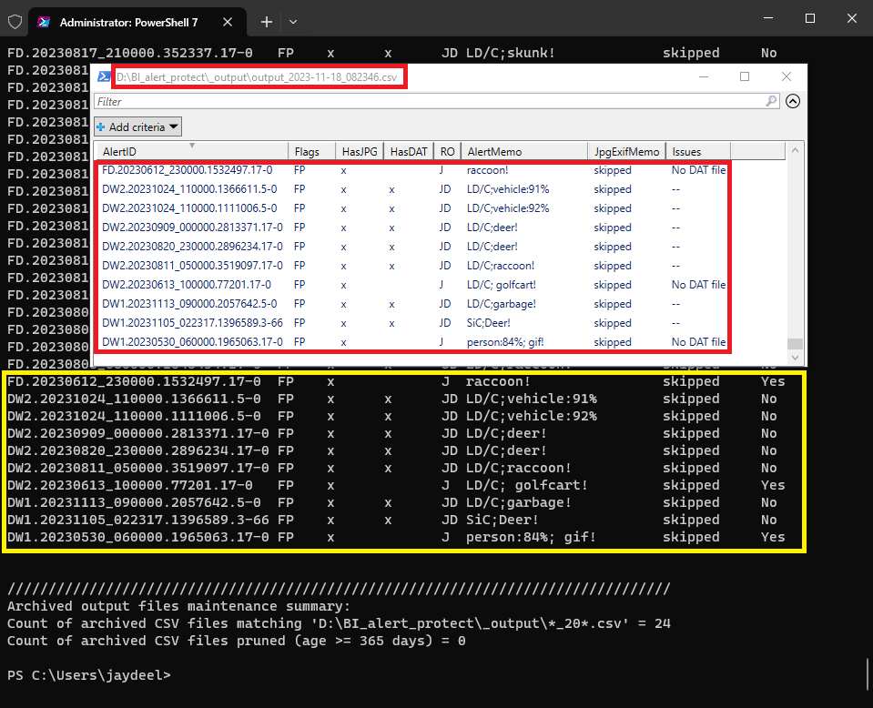

The response should look like following two screenshots
This screenshot illustrates the first screen of output to the PowerShell Console.
Key features are highlighted.
The 'Flags' column shows if the Alert's database 'Flagged' and 'Protected' flags are set.
The 'RO' column shows if the read-only file attributes are set for the JPG and DAT files (if they exist)
This screenshot shows the result after hitting the keyboard spacebar until all results are displayed.
Additionally, it shows the timestamped output CSV file (displayed over the Console output).
Note that this file contains the details for those issues that have a 'Yes' column entry in the Console output.

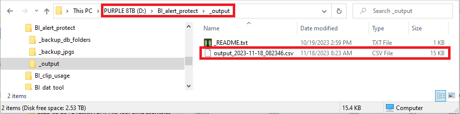

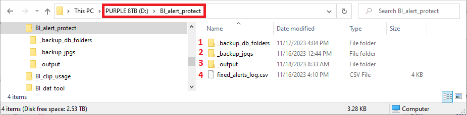

When executed, the script creates the following folders.
It also creates the 'fixed_alerts_log.csv' if any Alerts have been 'fixed'.
The timestamped output CSV file is located here:

The response should look like following screenshot.
Note that the 'JpgExifMemo' column is now populated. Furthermore, the 'JpgExifMemo' column entry is 'match!' when the JPG Exif matches the 'AlertMemo' column entry. Otherwise the entry is actual JPG Exif value ('Title' tag).

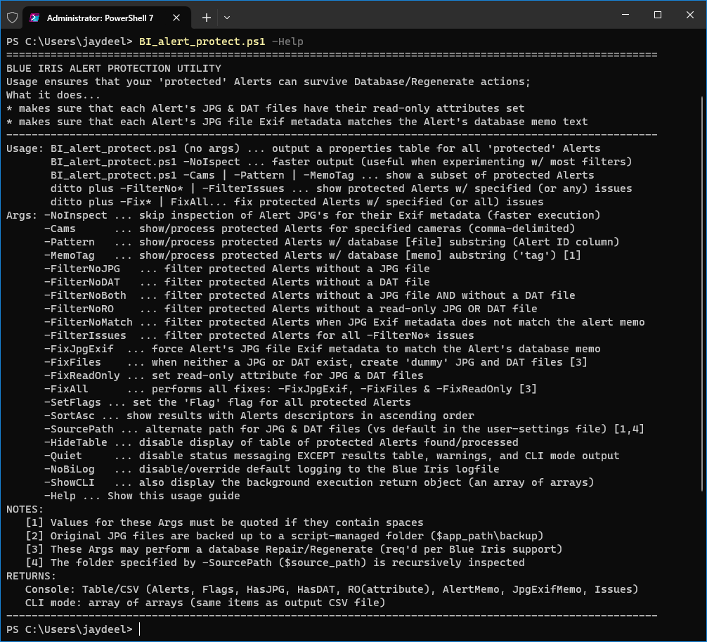

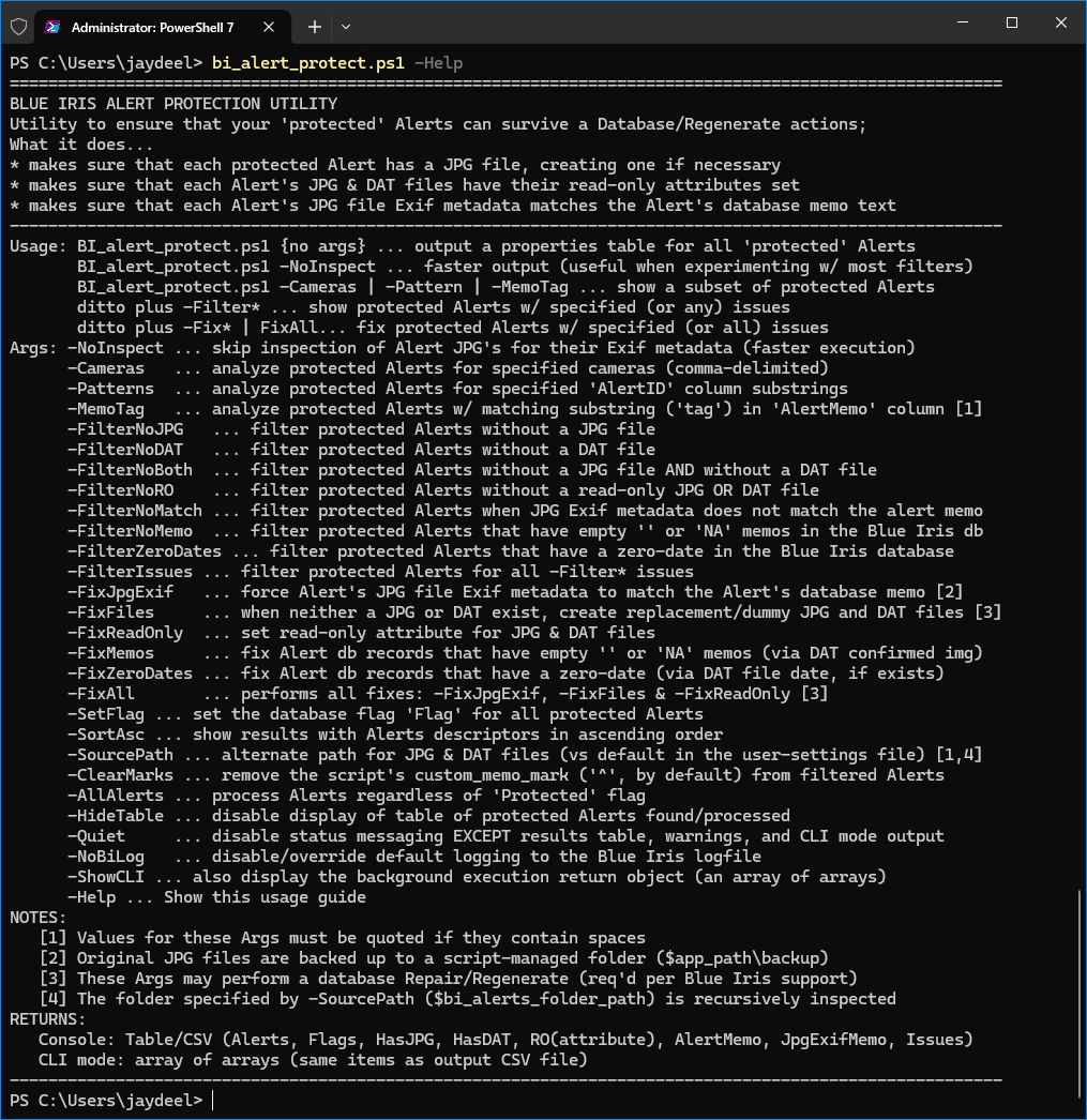

Finally, here's a screenshot of the script's help screen.

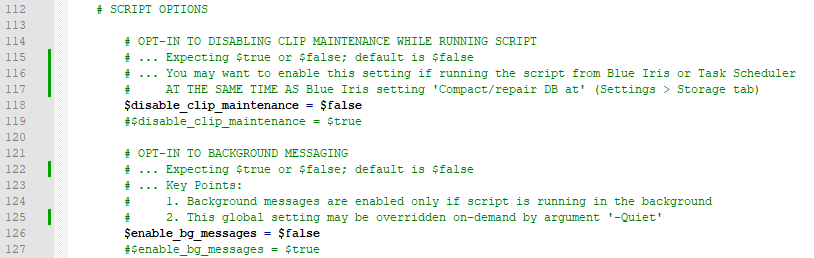

This new version may helpful if you want to automate the script via Task Scheduler (I'm running it daily).
It provides:

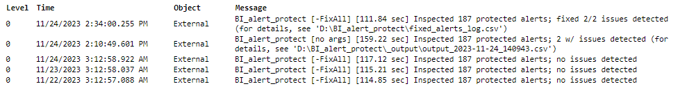

  • more informational messaging via the Blue Iris logfile (#6).
  • a user setting to confirm background execution (#5).
  • a user setting to temporarily disable database maintenance actions (#4).
Changelog:
  1. BUG: fixed script incorrectly detecting if running in background (via Task Scheduler, or Blue Iris)
  2. BUG: fixed duplicate entries in the 'Issue(s)' column in the script's log file ('fixed_alerts_log.csv')
  3. NEW: added progress bar for alertlist parsing (provides quicker console feedback when the script starts)
  4. NEW: added user setting $disable_clip_maintenance to avoid possible simultaneous Database/Repair actions
  5. NEW: added user setting $enable_bg_messages for temporary use to verify background execution
  6. IMPROVEMENT: made posted messages to the Blue Iris logfile more informative; now includes script's runtime, and counts of issues found & fixed
  7. IMPROVEMENT: argument -DevMode now outputs more timing information; demos the dummy JPG; saves each camera's alertlist
The following screenshot shows examples of improved entries in the Blue Iris logfile:
The following screenshot shows the new USER SETTINGS.

Current usage guide
bi_alert_protect.ps1 -Help
