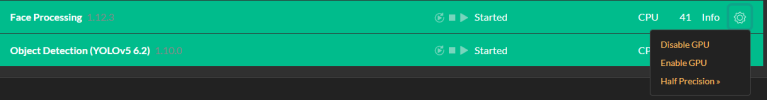

Hi to all!!! ive been searching for a while now but with no luck. i have blueiris in a dedicated PC, i have code project running on a Linuz machine, working great by the way, but this linux machine has an RTX2060 that i would like to use for codeproject, but i can get it to work. This is the system info from code project.
i have face processing and OD ( Yolov5 6.2 )
i have the option to select GPU on both models. for example like this:
but i press the ENABLE GPU, the module stop, restart and run again, but with CPU.

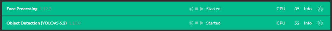

in the blue iris machine that is dedicated for blueiris i have:
detection is working but with CPU getting decent amount of pings, but i want to use the GPU.
