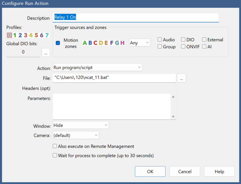

jaydeel! Thanks very much for putting me on the right path. I'm going to have to write this up properly, but the approach of running a batch file on the trigger event was the winning concept. The batch file contains the ncat command, which references the text file that contains the actual Relay On / Off command.
Here is the tl;dr on controlling an SR-201 relay under the trigger or alerts tabs in Blue Iris. I set this up as a pre-alert action set under the triggers tab. but it could be an action taken on alert.
There are three actions: Relay 1 On, Wait x time period, and Relay 1 Off. Here's the settings for Relay 1 On:
The file ncat_11.bat has the following content:
ncat 192.168.10.87 6722 <c:\users\.120\11.txt
The file 11.txt has the following content:
11
Transmitting 11 to the relay at 192.168.10.87 at port 6722 turns the relay on.
Turning the relay off requires the number 21 to be transmitted to the same address and port, so there is a text file called 21.txt that just contains the number 21. 21.txt is called by a file called ncat_21.bat, which has the same content as ncat_11.bat, but specifying 21.txt as the file to call.
