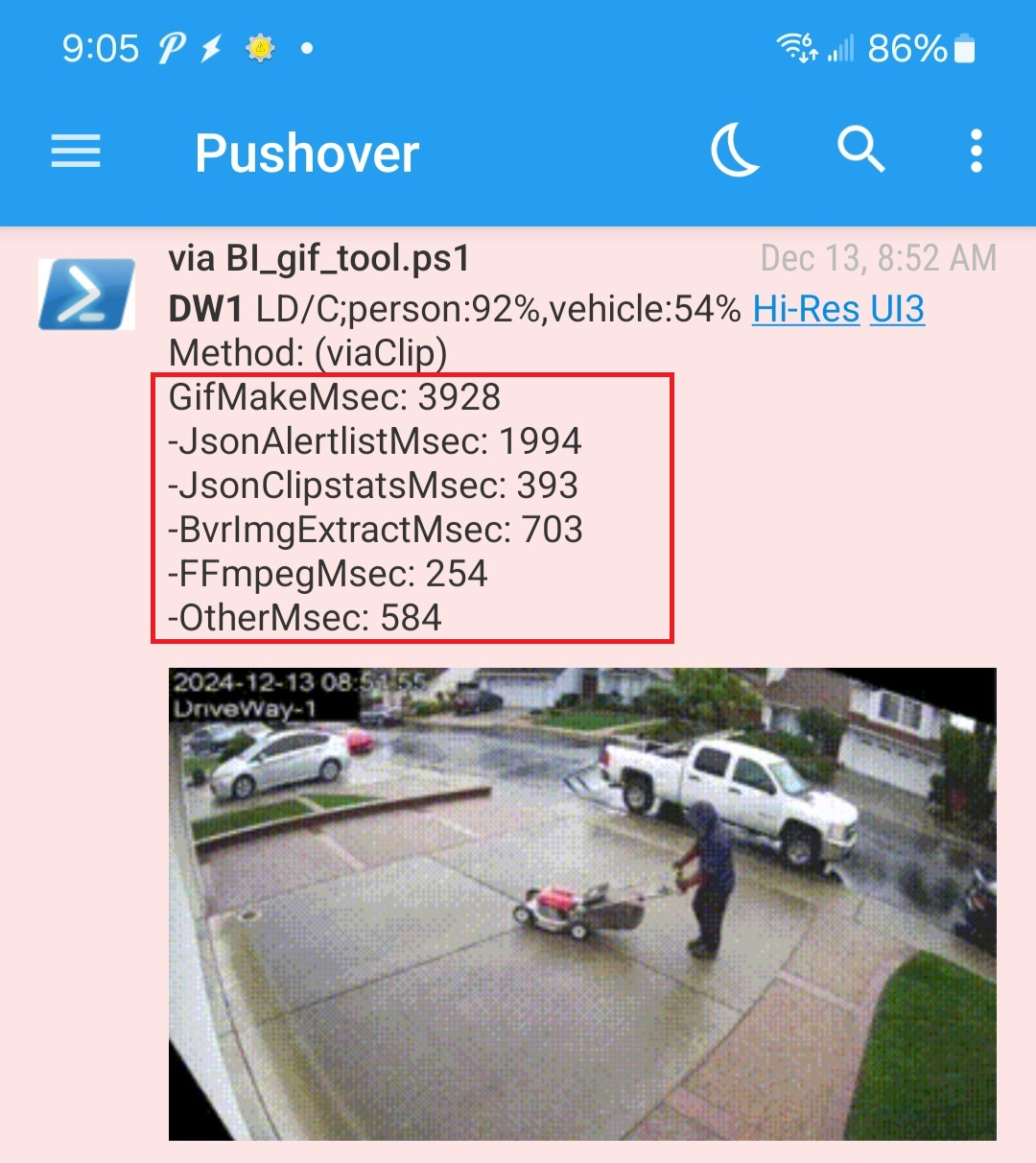

I really appreciate your incredible support each time I (or any other user) runs into issues running these amazing scripts, many thanks again.
... but the GIF make times I am experiencing are all over the place so far. The ones created through .DAT files are relatively fast (roughly 3-4 seconds in a short set of tests), but when the script has to fallback onto using the "Clip" method (JPEGS extracted from the .BVR), the full creation times spike to 20-23 seconds! Is that directly related to the alert length (ie: the script cannot complete until the Alert clip has finished)?
Currently I'm testing 5 cameras using the following command in the 'Run a program' action Params field and all are consistently creating GIFs from BVR-extracted JPGs without any delay.
Code:
"C:\ps_scripts\BI_gif_tool.ps1" -Camera '&CAM' -Latest -IgnoreDat -AlertMemo '&MEMO' -Msg """<b>&CAM</b> &MEMO <a href='&WAN/alerts/&ALERT_DB?fulljpeg'>Hi-Res</a> <a href='&WAN/ui3.htm?rec=&ALERT_DB'>UI3</a>""" -Priority 1
Is the command you struggling with using both arguments -Latest -IgnoreDat ?

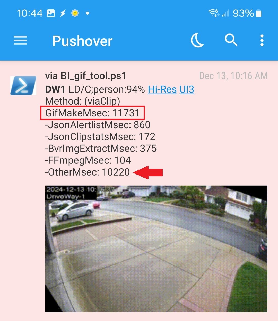

BTW, you can get an 'under-the-hood' peek of the script's timings by enabling two settings in the user-settings file: $append_performance_tag_flg and $append_performance_tag_details_flg. These will append additional info to the push message (highlighted in the red box in the screenshot below).
Doing this might provide some clues on what you are observing.
Reactions: jrbeddow
Seems I spoke too soon...
After my previous post, I started working on another project. Afterwards I decided to collect some more GIF notifications.
This time I saw reproducible delays.
Example:
I was able to restore the previous behavior by rebooting the server.
I'm reviewing the code to look for a better way to handle this situation, or at least minimize the delay.
BTW, I misspoke earlier when I agreed with your guess that the BVR extraction delay was determined by the alert's duration. It's currently 2 * (pre-trigger record time).
EDIT: You can experiment with user-specified delay durations via argument -BvrDelayMsec.
