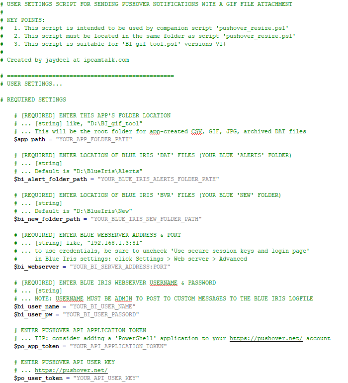

Edit the user settings file
The user settings file is named 'BI_gif_tool_user_settings.ps1'​
  1. Open the file in a code text editor (I use Notepad++)
  2. Edit the REQUIRED variables in the USER SETTINGS section (see screenshot)
  3. Ignore the remaining settings for now. They provide customizations that you may want to explore later.

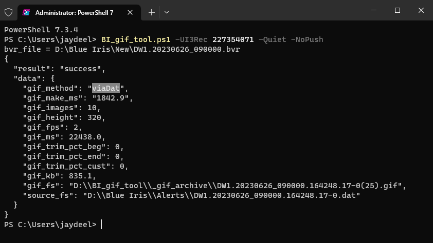

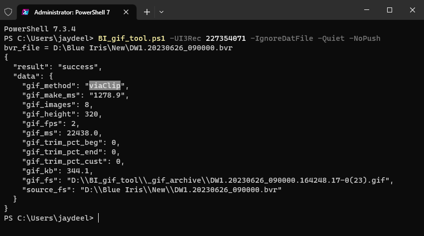

Test the script from the console
  1. Open an Admin PowerShell window, or Powershell-ISE window
  2. Select and copy the following command and paste it into a text editor (notepad is fine)
    BI_gif_tool.ps1 -UI3Rec xxxxxxxxx -Quiet
  3. Open UI3, select a camera, then select any alert that shows a duration (meaning it is done recording)
  4. Click in the UI3 browser's address bar, then select the value after the rec= argument, as in the screenshot below
  5. Copy the selected value to the clipboard.
  6. Return to Notepad, and paste the clipboard over the the xxxxxxxxx argument value
  7. Select the entire command, then copy/paste it to the Powershell console.
  8. Hit the Enter key.

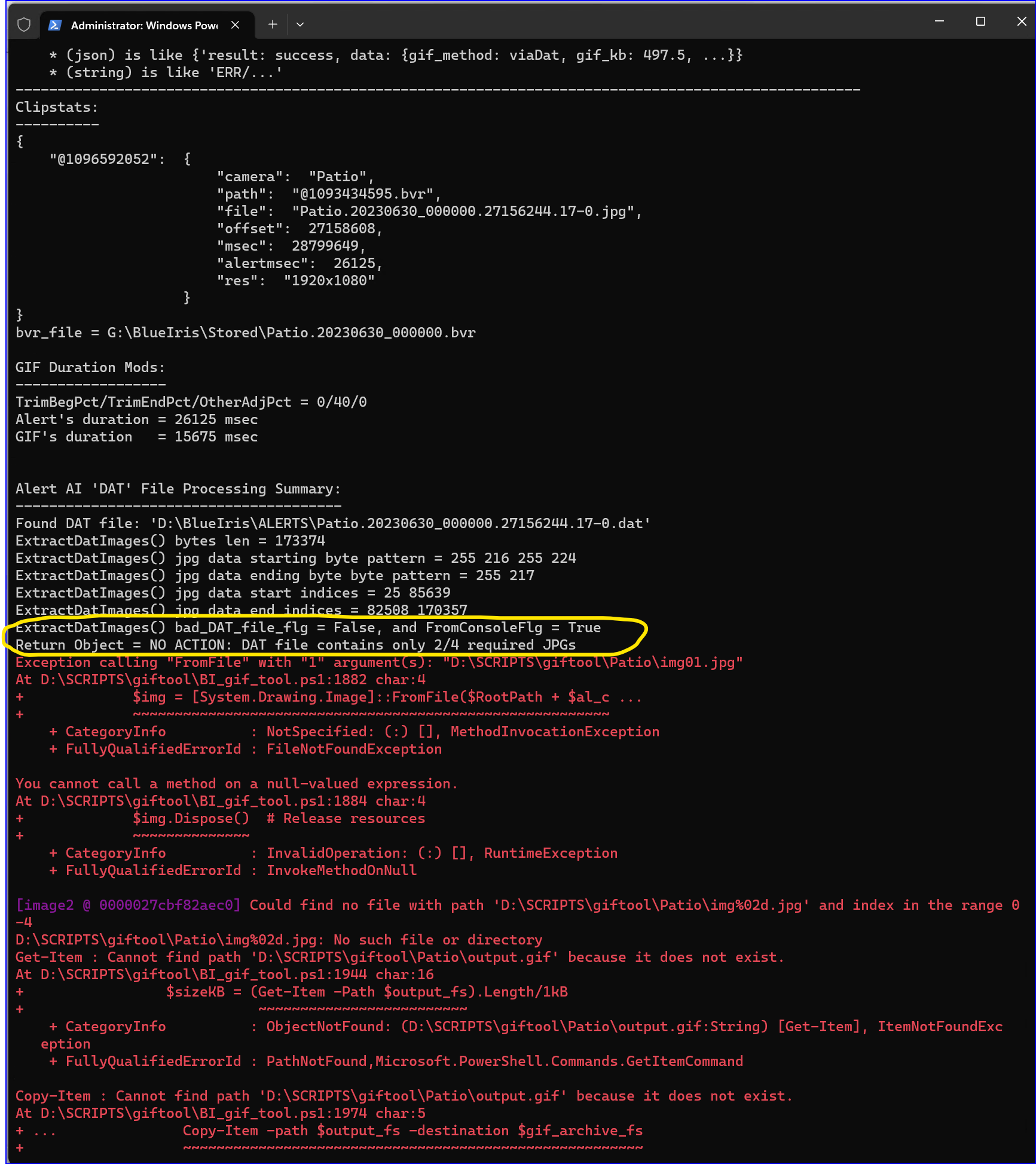

The response should look like one of the following 2 screenshots. You should also receive your first GIF Pushover notification,​
If this camera was configured to create an AI DAT file with sufficient images, then the response will look like the 2nd screenshot​

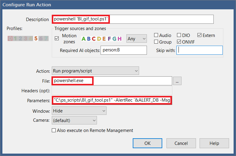

STEP #5:

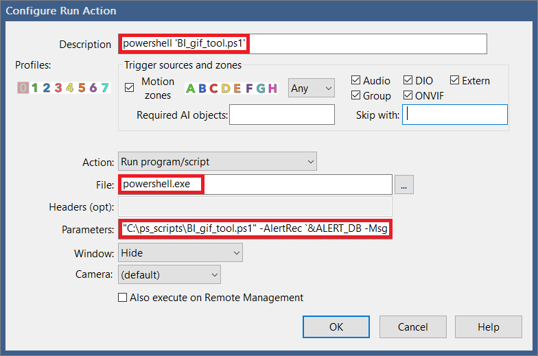

Test on a camera Alert action set
  1. Click 'Camera settings' > Alerts tab
  2. Click 'On action..." to open the action set
  3. Create a new 'Run a program' action, and configure it as shown in the following screenshot
  4. Safe the changes.
  5. Trigger the camera - IMPORTANT: by actually walking across its FOV
Here's the copy/paste code for the 'Parameters' field...​
Please note that the backslash (\) in the -AlertRec parameter, and the triple double quotes (""") in the -Msg parameter are ESSENTIAL.
Code:
"C:\ps_scripts\BI_gif_tool.ps1" -AlertRec \&ALERT_DB -Msg """<b>&CAM</b> &MEMO <a href='&WAN/alerts/&ALERT_DB?fulljpeg'>Hi-Res</a> <a href='&WAN/ui3.htm?rec=&ALERT_DB'>UI3</a>"""
or...​
Code:
"C:\ps_scripts\BI_gif_tool.ps1" -IgnoreDatFile -AlertRec \&ALERT_DB -Msg """<b>&CAM</b> &MEMO <a href='&WAN/alerts/&ALERT_DB?fulljpeg'>Hi-Res</a> <a href='&WAN/ui3.htm?rec=&ALERT_DB'>UI3</a>"""

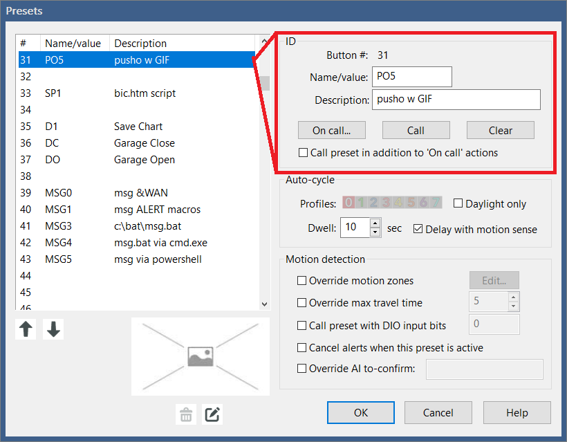

and/or test on a camera Preset
  1. Click 'Camera settings' > 'PTZ/Control' tab
  2. Click 'Edit Presets..." to open the preset editor
  4. The code for the 'Parameters' field is the same as above

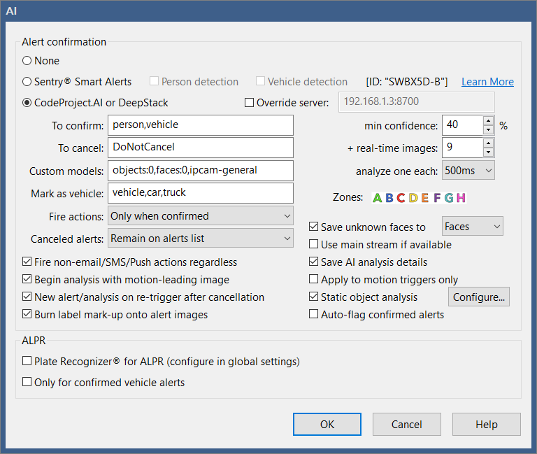

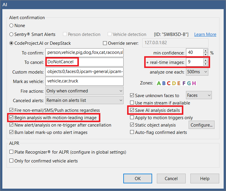

Configure a Camera to always create an AI 'DAT' file
  1. Click 'Camera settings' > Trigger tab
  2. Click 'Artificial Intelligence..." to open the AI dialog
  3. Configure it as shown in the following screenshot

I should note that the script automatically logs all activity to a CSV file in the script's root folder $app_path.
The source file (DAT or BVR), GIF properties (image count, height, duration, size, etc.), and script performance times are logged.
Similar data are also logged to the Blue Iris logfile, if you've configured this in the user-settings file (setting $post_to_BI_logfile_flg).
Reactions: scoob8000
This is great, thanks for all the work! I'm trying it out now and first thoughts are:
  1. Why does it need my (or "an") admin username and password? I understand that it must be necessary, but why? Looks like API calls to BI... but I'm wary putting that info in a script that I haven't fully read yet. I appreciate the well documented code though.
    Eventually I plan to create a "giftool" user and make it admin and put a lot of restrictions on it. Still, non-admin would be easier to go with.
  2. How is my pushover API key, user, device NOT among the required settings in Part 1 Step 3? You must need that, no? Looks like it has your pushover key, etc? If I test this will it send you my images? I assume this is an oversight? :lol:
  3. Your examples in Part 3 all show "BI_gif_tool.exe", but the script is just a .ps1?
In any case, this looks awesome and I can't wait to begin using it!
Reactions: TonyR

1. The script sends the following JSON and HTTP interface commands to the Blue Iris web server.
  • JSON cmds: login, logout, cliplist ... cliplist do not require admin credentials
  • HTTP commands: /admin/log ... this one requires admin credentials
2. You are correct. Will be fixed in V1.4. (post #1)
3. You are correct. I've fixed the typos in post #3
If you are ok with not using the Blue Iris logfile feature, a non-admin account may do it for you.
Thanks for the sharp eyes!!

Had some trouble but finally got it working! My problem was not enough images because I didn't add a "DoNotCancel" in the AI settings (post 1, Step #6 -- my bad).
The error handling/reporting for "not enough images" didn't work out quite right, I had to add some debugging to be able to see the error message on the console, even without -Quiet.
I added some Write-Host's to get the output circled in yellow. Otherwise I just got the errors in red, no gif files, and not much indication why.
The error lists 2/4 images, but I think it should have said 2/6 because $gif_DAT_reqd_images = 6 in the 1.5 settings file I was using?
Pushover only shows two frames in the message list and message view, on my iPhone. I had to click on the message, then click on the gif to see all 8 frames animating.
Also should the default PO priority be Emergency? I've set mine back to 0.
Thanks again for making this! I've wanted animated gifs since discovering pushover.

Glad you got it working.
I'll add better error trapping for the condition you noted, and post V1.6 in the next day or so.
BTW, if you do update, please note that you can reuse the user settings file, so be sure you don't overwrite it when unzipping the update.

  • I was having the same issues; however, with the exact opposite solution. When I used DoNotCancel, CP-AI would not detect anything. I tried using +real-time images starting at 3, 4, 8, 12, 50, and 999 and various analyze timings
  • With "To cancel" empty, I get the "Warning: DAT file has fewer images than required (3/4)" with any +real-time images listed above and analyze setting 100ms and above
  • This script works perfect with "To cancel" empty, +real-time @ 999, and analyze set at 50ms
@jaydeel Thanks for the script! This works great. I had a slight learning curve as I no knowledge of PowerShell (and programming), but I was able to figure out my problems such as setting environment variables to get the script recognized by PowerShell.
Reactions: jaydeel
Thanks for the description of what is working for you.
Out of curiosity, a few questions/comments:
  1. With your settings in the last bullet, how many images are typically captured in the DAT file?
    (You can determine this by opening some DAT files… or easier, this should be indicated in your pushover notification messages by the ‘(DATx)’ label if you have user-setting $append_DAT_tag_flg=$true).
  2. How many cameras are you using the script on?
  3. I understand that every camera’s field-of-view requirements are different, but to me ‘Analyze one each’ at 50ms seems quite fast. I typically use 500 (on my driveway cams with faster moving objects) and 750 ms (for my other cams - entry, front door, gate, etc. - where people and animals are the primary objects). See the screenshot below.
  4. I’d be interested in seeing your script’s log file (BI_gif_tool.ps1.csv). Would you be willing to DM it to me?
Thanks for description of what is working for you.
1. Majority of the time I am getting about 5-6 images, highest up to 9 images.
2. I am running the script on six 4K cameras and two 2MP cameras. I am running a dedicated server with a threadripper x2950 processor, 32GB of ram, and a RTX 3060 GPU. The GPU is running both NVDEC and CP-AI. GPU maxes out at 42% utilization with 7.5GB out of 12GB VRAM in use.
3. I normally my settings at at least 250ms. That said, I am actually very impressed with 50ms. I don't know why, but my people hits have a higher percentage rating than before. This includes nighttime in a dark walkway lit up by infrared.
4. I'll send it right over to you.

@jaydeel
Awesome script! Thanks for putting it together!
Ran into a hiccup with forgetting to reboot the host after adjusting the environment vars, but everything else went smoothly! This is much more polished than my old pieced-together scripts for the same function (I was using scripts to convert jpg alerts into GIF).
Just one problem: I can't seem to get the priority adjusted. Any ideas what might be causing this? I've used many variations of the following, but the pushover priority always remains at emergency (2)
"G:\BlueIris\custom-scripts\BI_gif_tool.ps1" -AlertRec \&ALERT_DB -Msg """<b>Hi! Activity at the door (&MEMO)</b>""" -Title """home notification""" -Priority 0
-Priority "0"
-Priority 0
-Priority ""0""
It may be a bug... checking now.
EDIT: Confirmed bug. I mistyped the -Priority parameter as [string] instead of [int]. PS7 was forgiving, but PS5 was not.
When Powershell is executed in the background (e.g., from a Blue Iris Run-a-program action), scripts are executed using PS5.
When I test scripts from the Console, I'm usually using PS7. I forgot to test also in Powershell-ISE, which uses PS5.
Reactions: silencery
