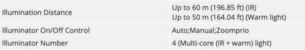

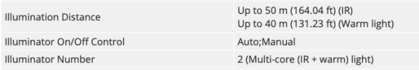

WizColor 5x59-PRO turrets have 2x more multi-core lights, 10 meters longer distances:
In bullets there are always 4 multi-core lights, but some chassis models (like Z4E) have longer distances..

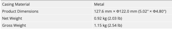

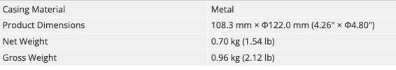

WizColor turret (and bullet) are bigger:

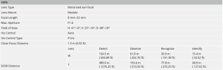

- varifocal WizColor 5x59-PRO will have P-Iris.
P-Iris is ability to close aperture in good light condition for better Depth of Field - to cancel limited DoF for open F1.2 aperture...
In Smart Dual Light 5x59-IL line only telephoto Z4E model will have this feature (P-iris)...
Close Focus Distance is very low for varifocal models with P-Iris (16 cm :)

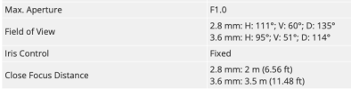

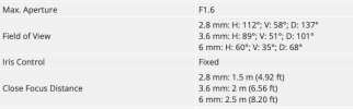

- Fixed lenses WizColor 5x59-PRO will have little longer Close Focus Distance than Smart Dual Light 5x59-IL (due much more open F1.0 aperture). Difference will be bigger for 3.6mm lenses (3.5m vs 2m)..
FoV for fixed 2.8mm lens is almost identical. But for 3.6mm lens if very different (95 vs 89 degrees horizontal)...
