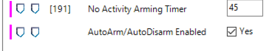

Im trying to set my panel to auto arm on inactivity. I want the panel to arm should I forget to arm the system when I leave.
I am using DLS to connect to the panel, and am in [181] and [191]. It does not seem to arm, I did manage to have the keypads to give a solid audio tone while in auto arm at a certain time (10:35)..... has anyone set it up like that?
What is [199] set to the default of 4 minutes? You should be able to pull the event log.
Try turning off the No Activity Arming Timer [191] it may do something else.
