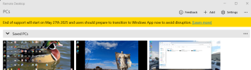

I am late to this party. Who has used the "Windows App"???
Reactions: mat200
For PC to PC, the Remote Desktop Connection is still functioning fine for me.
For Android (and I think iOS), the former RD App has been replaced by the "Windows App". Apart from having a name that is completely generic and hard to search for, it does still provide the same remote access features.
About the only thing I don't like is it no longer gives a thumbnail of the specific PCs but a generic image representing the OS.
Reactions: mat200 and sdkid

Okay, I just downloaded the "Microsoft Remote Desktop" app and the newer "Windows App" app.
Yikes.
"Microsoft Remote Desktop" is slower than the original Remote Desktop Connection and seems to offer no reason whatsoever for me to switch to it. But it is, at least, what it claims to be. A more modern version of Remote Desktop Connection.
"Windows App" is a whole new horror. It was touted as the replacement for remote desktop connection. What a joke. "Windows App" isn't even a remote desktop client. It is a client for certain cloud virtual machines rented from Microsoft/Azure. That appears to be all. You can't use it to connect to a PC you own.

I'm using Windows App to connect to my home PCs (see my earlier screenshot). You still need a way to VPN to your home network if you want remote access.
And yes, local RDC access also works and won't go away.
They must have hidden it then. hmm.
As @bp2008 said, Remote Desktop Connection is built into Windows 10 and 11 Pro and works fine. It's not going away.
It's pretty basic though. I actually use Remote Desktop Manager on one computer and mRemoteNG on another. I like Remote Desktop Manger better.
I installed Windows App again. Still no way to add any devices. Everything about this screams to me "this is just an MS cloud product client".
Maybe you guys successfully using it for local connections are using a different version from somewhere? This is just what I get when I install Windows App from the microsoft store on Win11.
This behavior (cloud-access only) seems to be intentional only from the Windows client and web client. Evidently mac and mobile clients can connect to things you actually own. But not the Windows version for some reason?
Reactions: looney2ns
I'm still using RDC for access from other PCs. But for mobile devices, you must switch to the "Windows App".
