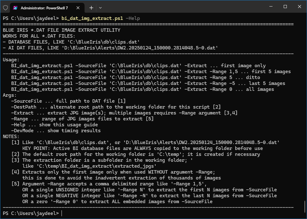

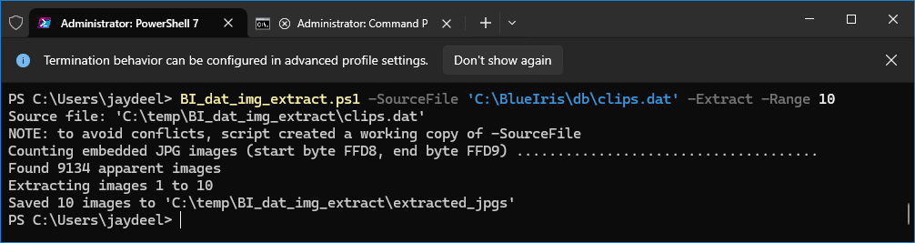

Here's a screenshot of the Help menu...

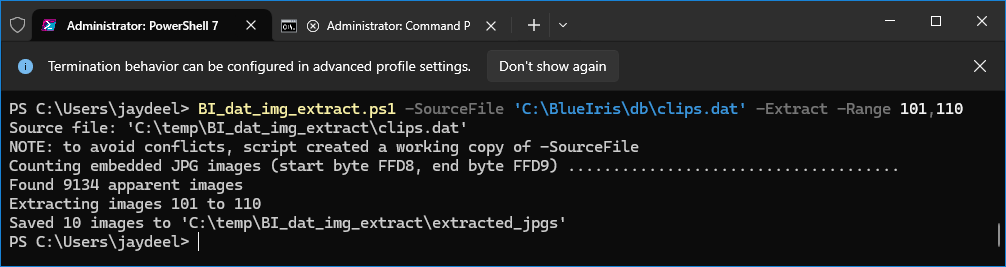

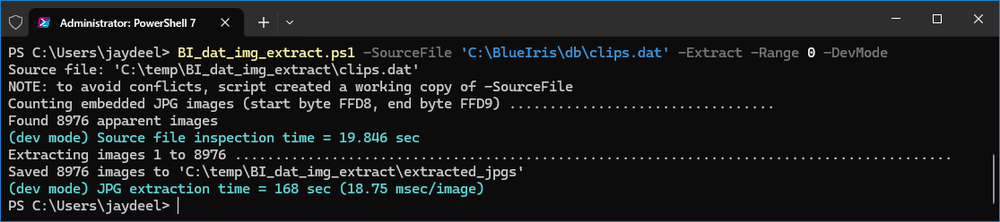

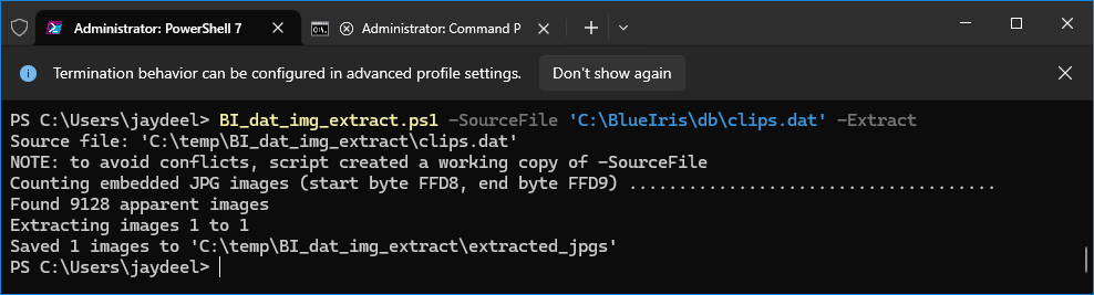

Here are some typical commands...

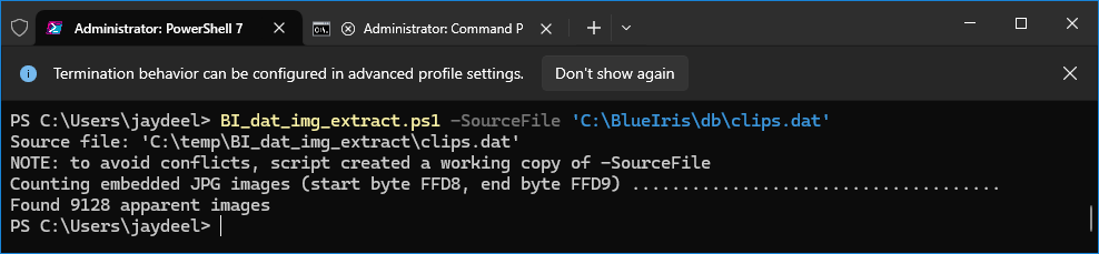

BI_dat_img_extract.ps1 -SourceFile 'C:\BlueIris\db\clips.dat'

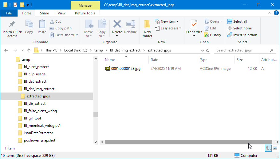

... counts the embedded JPG imagesBI_dat_img_extract.ps1 -SourceFile 'C:\BlueIris\db\clips.dat' -Extract
... first image onlyBI_dat_img_extract.ps1 -SourceFile 'C:\BlueIris\db\clips.dat' -Extract -Range 1,10

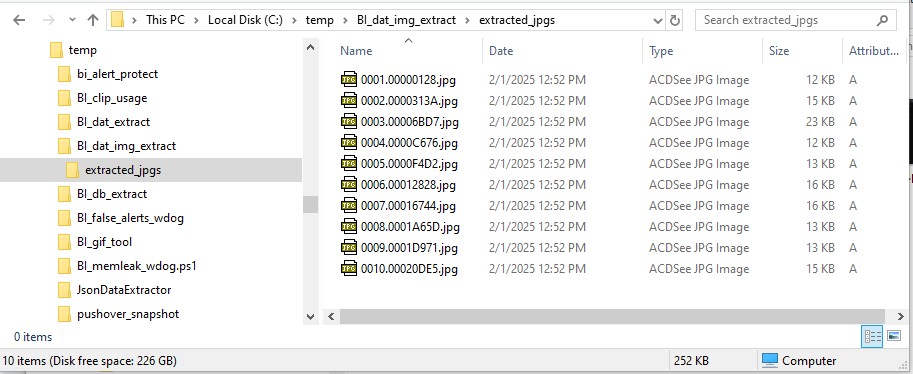

... first 10 imagesBI_dat_img_extract.ps1 -SourceFile 'C:\BlueIris\db\clips.dat' -Extract -Range 10

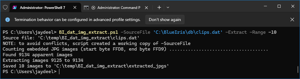

... dittoBI_dat_img_extract.ps1 -SourceFile 'C:\BlueIris\db\clips.dat' -Extract -Range -10

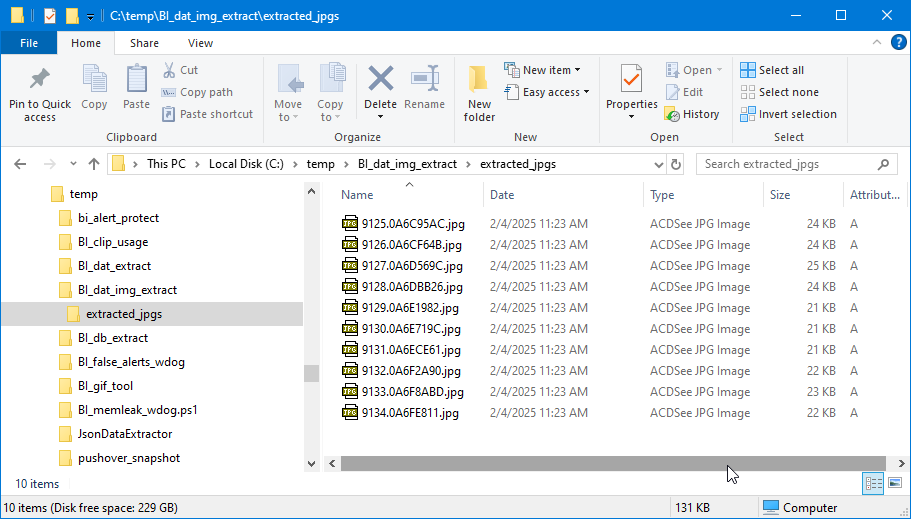

... last 10 imagesBI_dat_img_extract.ps1 -SourceFile 'C:\BlueIris\db\clips.dat' -Extract -Range 0

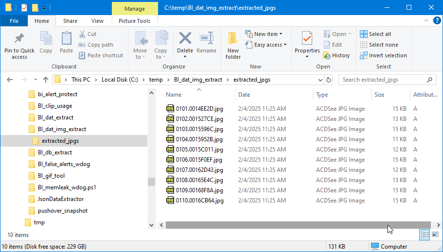

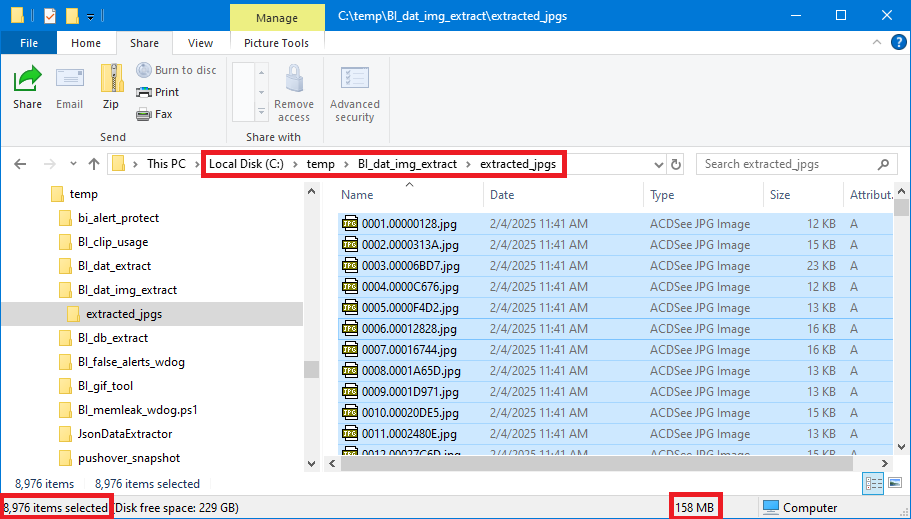

argument.The JPG filenames are like
, where the first value is image number and the second value is the hexadecimal offset of the start of the JPG image in the binary file.The screenshots below illustrate typical output...

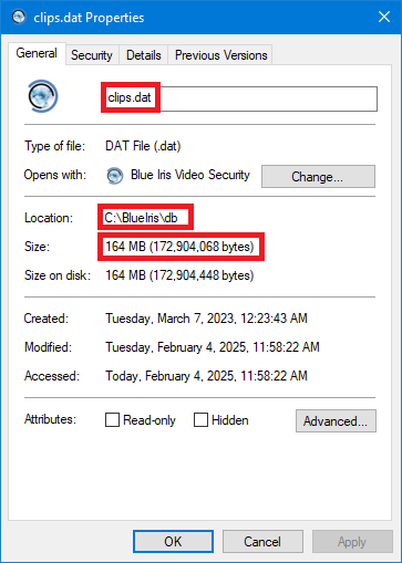

1. You cannot specify the alert/clip to extract a specific JPG from the BI Database clips.dat file. For that you should use HTTP commands below.
2. The script will not directly use active BI database files; they are ALWAYS copied to the script's working folder before use.
3. The script can take awhile to interrogate the BI Database clips.dat file; you should see a progress indicator that it's working.
