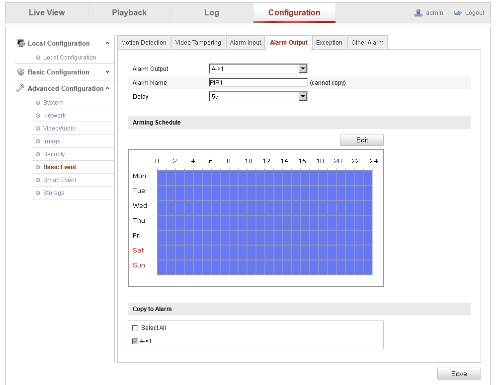

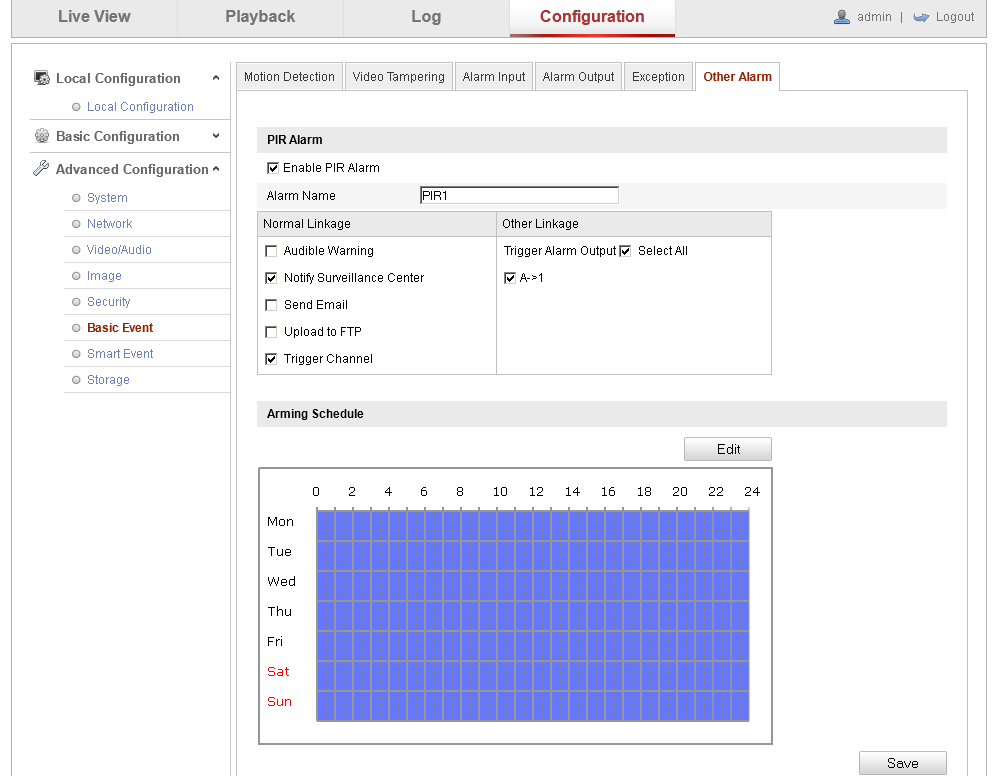

How do i configure iVMS-4200 PCNVR to record on 2432FIW's PIR? There are 3 options in iVMS-4200 PCNVR - record on motion detection, record on alarm, record on alarm and motion. As i understand i should make PIR send alarm output which iVMS-4200 PCNVR will record on?
Here is what i did:
1. In iVMS-4200 PCNVR in record template i've chose[customize] and draw [alarm] from 0 to 24 on all days.
2. Configured [other alarm] in 2432FIW to the following:
http://easycaptures.com/fs/uploaded/1036/5268580403.png
3. Configured [alarm output] in 2432FIW to the following:
http://easycaptures.com/fs/uploaded/1036/2184758579.png
Still it's not recording. What am i doing wrong?

did you try to set "All events" a record settings?
Sep 20, 2015
23
no, will try - but won't this make it record from also from regular movement detection? (though it is disabled on camera, so should work)
Thank you for suggestion, will try and report back.
badmannen
Nov 24, 2015
506
29
Italy
Yea I meant more just to check that it works at least and then work your way backwards to the "correct" way
Sep 20, 2015
23
UPDATE:
badmannen's suggestion worked.
"All events" does record on PIR and when disabling all other alarms/detections on cameras only PIR triggers the recording.
Thank you Italian guy;)
