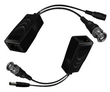

I would use a cctv video balun (bnc to cat5) on both ends.
like this one:

That's not bulk cable and everything there says Cat6. But that's beside the point of your question. Unless you got a great deal and/or can't return, I'd go with POE cams myself. Otherwise as above, use the baluns. Not clear which junction boxes you have to say what they'd fit.
