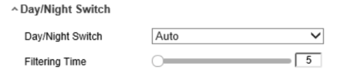

Approx every 10 seconds I hear a 'click' from the camera and it toggles between night mode and non night mode. See attached screenshots.

Infrared is light and you are getting a ton of IR bounce off the cable or whatever it is that is making the sensor think there is enough light to go to color.
Get that bright white thing out of the field of view.
Also get the camera off of default settings. Once you speed up the shutter, this kinda stuff goes away.

I tried to change the angle of the camera to something where I do not think that I have any obvious things that makes the light bounce back - but the problem persists.
Or do you still think that there are bounce back here that makes trouble? New images attached.
How to change and what shutter settings do you recommend?
Yeah that is still a lot of IR bounce.
