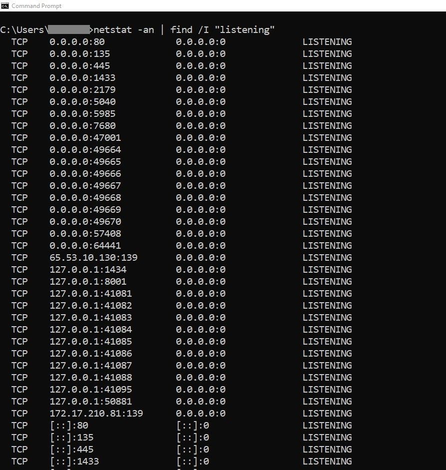

Not sure if it helps but mine got stuck at
System.Net.WebException: Unable to connect to the remote server ---> System.Net.Sockets.SocketException: No connection could be made because the target machine actively refused it IPadresss:80
and i solved it with this :
