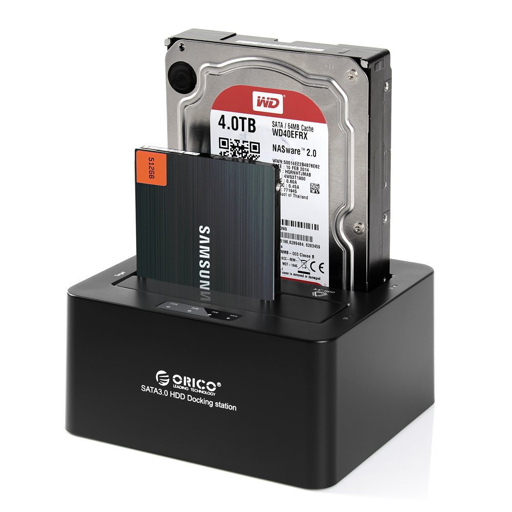

I see that there are two types of enclosure for these hard drives. One is a total enclosure, a box sometimes with a fan. The other is as shown below, a docking station. Any one have an opinion on which my be better for the video application?
