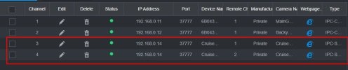

I have connected the IMOU Cruiser 10MP Dual Lens Camera to a Dahua NVR, but I'm experiencing an issue where only the PT lens motion detection recordings are being stored on the NVR. There is no playback or recorded video of motion detection/human detection for the fixed lens. Could anyone please provide a solution to this problem?

Channel 4 does not have SMD enabled so no human detection, just regular MD is enabled
Also on image #3, the Schedule. that shows channel #1, is channel #4 set to record in the Schedule?

Thank you for looking into the issue. I've tried enabling human detection on Channel 4 (which is the fixed lens of the Cruiser Dual). Every time I enable it and click OK, it says the settings are saved successfully. However, when I refresh the page, I see that all the settings I've done for Channel 4 are disabled again.
For image 3: schedule set to same as channel 1.

What browser are you using. All Dahua equipment is browser sensitive. Needs to be IE or Edge in IE mode
And can you show the playback timeline on the NVR? Are you certain it isnt recording?

Thank you for helping me with the issue. I removed the camera from the NVR, re-added it, and reconfigured the settings. Now everything seems to be working fine. Both lenses are recording and playback is available.
