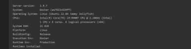

Proxmox Virtual Environment is based on Debian Linux.
BlueIris runs in Windows, and Windows runs as VM in my Proxmox host PC.
CodeProject runs in docker inside another VM of Debain Linux.
Backup/restore Windows VM or Linux VM takes 2-17 minutes depends on file size. Then I can restore the backup in about the same amount of time.

So have you tried CP in Blue Iris?
I had a P620 in a Tower PC, it created a lot of heat and lots of noise.
I now have MiniPC and a NAS. CPU does everything just fine and I don't chase after 20ms.
I assume you have the i9 water cooled...yeah I too am not trying to get 20ms times on AI. I do have an old 970 Nvidia card in my Blue Iris PC which is running CPAI on it too, I avg. about 100ms probably a little less, don't know have not checked it in awhile. Where we live now, not much AI needed, very little traffic. Just the wife and I, our dogs and the occasional front door Delivery, oh and alot of Deer and Rabbits :) Stray Dogs too :), we live in the rural country now.
