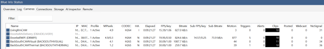

How do I ensure blue iris is keeping count of NoSignal? What setting is it? 3 of my cams it works as expect. The other 5 always show 0. Any help would be appreciated.

Yes, but I recall disabling the tracking of no signal counts. I just can’t recall what I did. I am confident these cameras are getting no signal blue iris just isn’t reflecting it.

figured it out, there is a camera setting on the watchdog tab labeled Restart Camera Window After xx sec. I had this box checked. I simply unchecked this option in watchdog and I am back to seeing no signal count appropriately.
Thanks Everyone.
