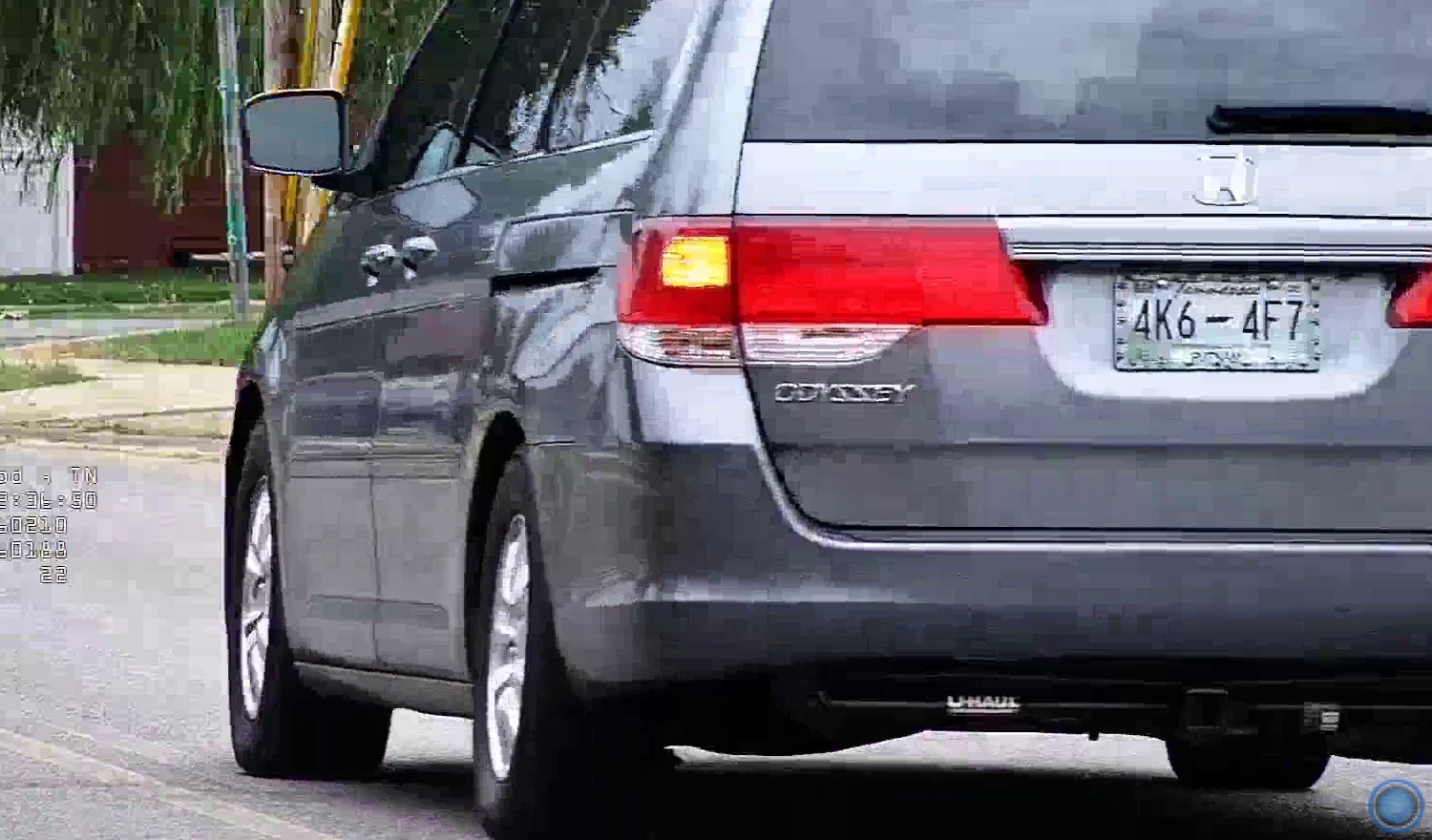

Here are a couple samples, a bad one (blurry, shutter speed too low) and a couple good ones where the OpenALPR agent has good images to read the characters from.

Here are two samples from the local setup that I'm running.
This plate was stored as "F5309":
This one saved as "0LQD":

For me, the normal views of vehicles result in plate images about 120 pixels wide in the farther lane. My previous cam got plates at about 100 pixels horizontally (and good accuracy). If your snips are at 100% scale, they're coming out around 75 pixels wide and the font is also small and harder to read. Would your camera be able to zoom in further to increase the effective size of the plates? Also, could you check if you can boost your camera's bitrate? That day photo looks like it might benefit from more bitrate.
I think dewarp may have gotten automated, my OpenALPR doesn't have a GUI option for dewarp anymore and I think the release notes said something like that. I attached a sample of mine at about a 70-degree crossangle. At that angle, conditions have to be pretty good (vehicle nearly stopped, decent light, non-recessed plate, etc) but it will OCR it very well in those cases.
