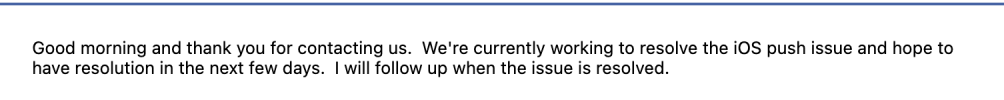

Support responded to my support request yesterday and said they had the fix and pushed the update yesterday as well. Version (5.9.9.49). I updated but it's still not working.
I see that 5.9.9.50 is out now, perhaps it will fix your problem. Nothing in the help file "Update Notes" about this release!
