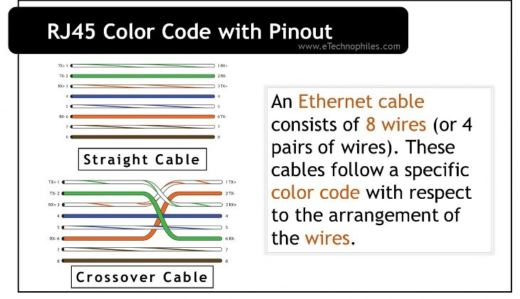

The wires in the connector are not correct. They need to be, with the connector viewed with pins up and lock tab on the bottom -
white/orange, orange/white, white/green, blue/white, white/blue, green/white, white/brown, brown/white
This is known as EIA/TIA 568B.
Full information here -
