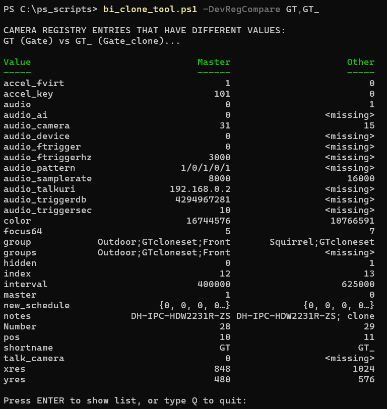

  • Includes an optional registry comparison mode for troubleshooting.

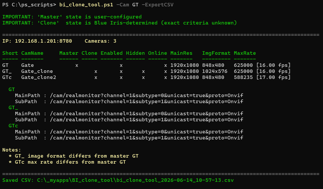

Example Screenshots:

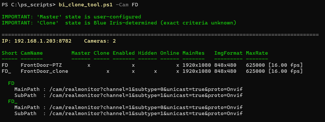

In this example, Blue Iris recognizes the attempted clone, which has matching interrogated properties - except that it is hidden.
In this example, Blue Iris is recognizing both attempted clones despite the ImgFormat and MaxRate differences.

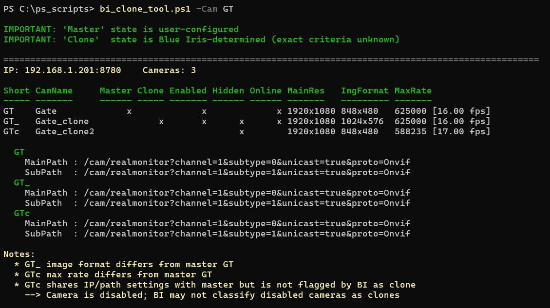

In this example, Blue Iris is not recognizing one attempted clone because it is NOT enabled.

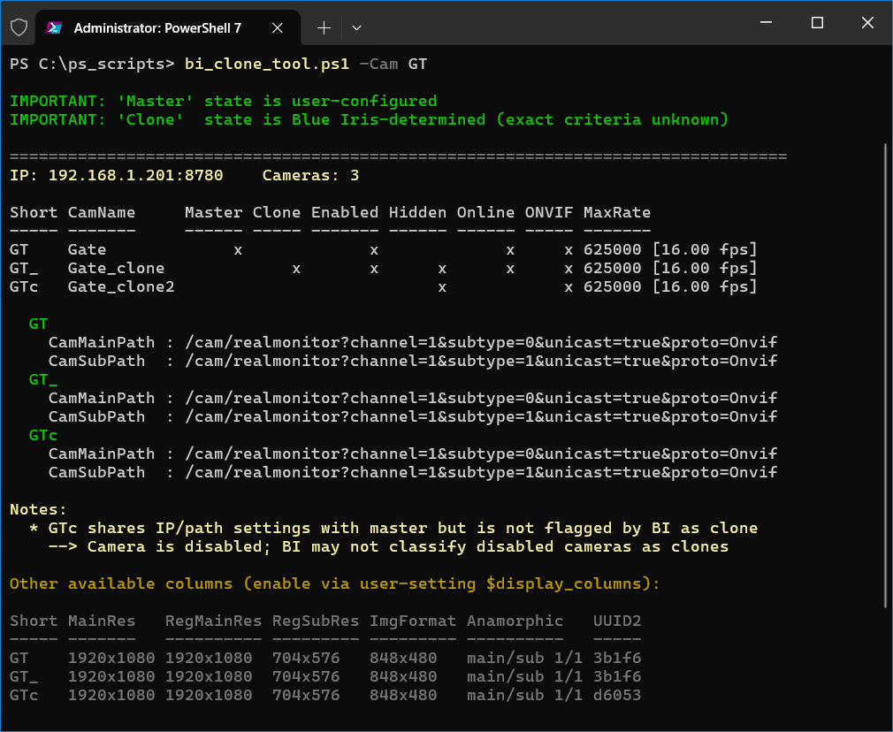

Here's an example of an unusual attempted clone configuration that this tool helped uncover.
I had a camera that Blue Iris would not recognize as a clone, despite the fact that it shared the same IP address as the intended Clone Master. The script also showed that the main and sub stream paths, Image Format, and Max. rate settings all appeared to match.
Using the -DevRegCompare option, I eventually realized that I had originally created the clone from a different physical camera that had occupied the same location years earlier and was later replaced. I had hidden the clone and simply overlooked it during the camera replacement (out of sight, out of mind).
Although the current camera and its intended clone shared the same IP address and appeared identical in all obvious clone-adjacent settings, Blue Iris still refused to classify the camera as a clone.
This suggests that Blue Iris may track additional camera-specific information beyond the settings exposed in the UI, JSON API, or obvious registry values. Recreating the clone from the current camera resolved the issue.

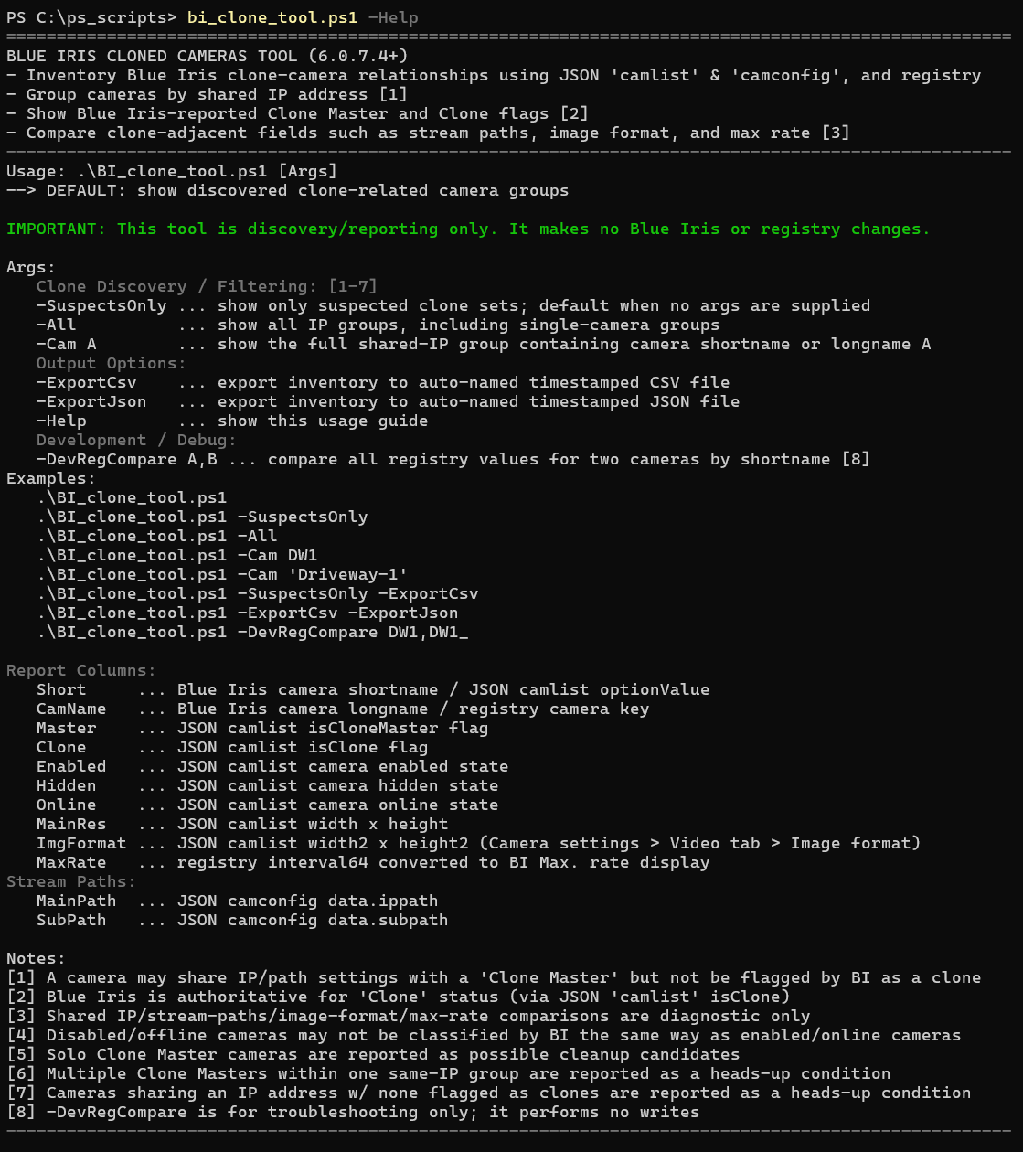

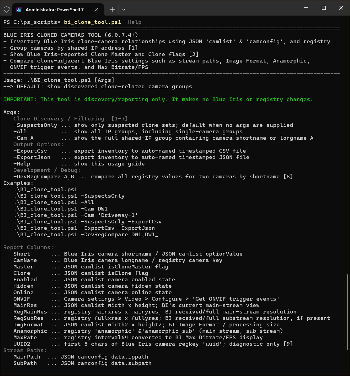

Here's the help screen
The tool is discovery/reporting only and makes no Blue Iris or registry changes.
Feedback, bug reports, and enhancement suggestions are welcome.
