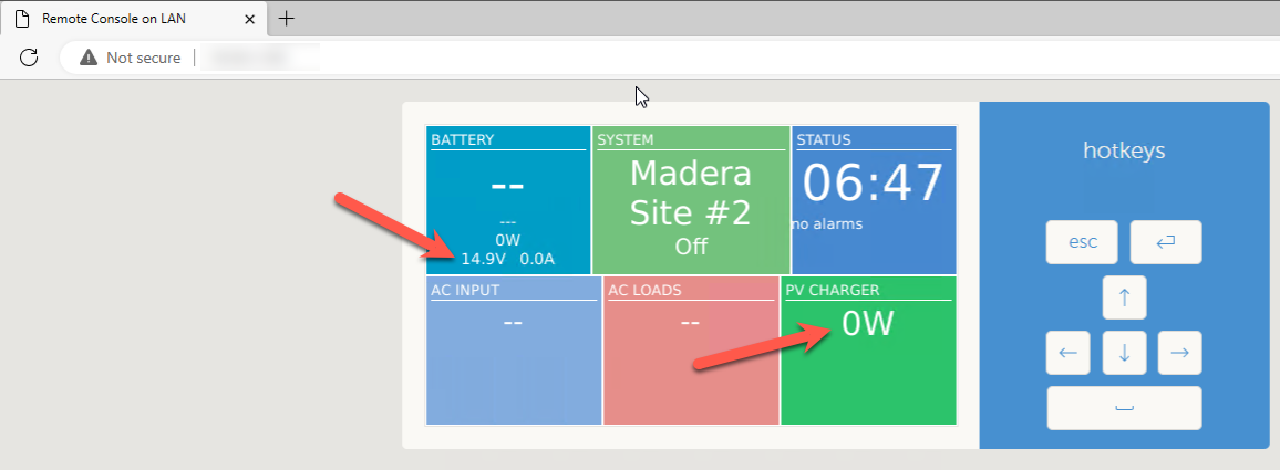

I am also able to access the WebUI for the VenusOS PI that displays the info as well

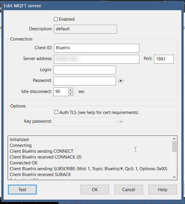

I did test in BI that it can communicate with the MQTT server on the VenusOS PI as well. Just not sure if this is really for alerts or if BI can pull info from the MQTT subscription to the VenusOS Pi?
It would require 3rd-party software to get the desired values from the MQTT broker and save them to a text file (or files) on the Blue Iris machine. I'm not aware of any software that does this, but you may be able to find something if you look hard enough. Then Blue Iris Settings > Macros has the capability of loading text files into macro strings that you can use in text overlays.
Although Blue Iris's interface only exposes 9 macro slots, there are actually 999 slots available if you assign values via HTTP web server command: /admin?macro=x&text={text} Set macro number x=1-999 to value {text}

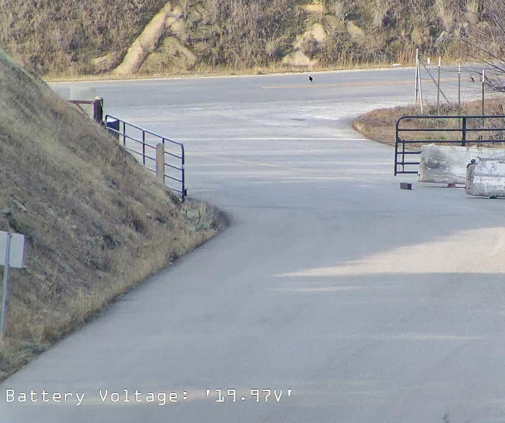

5. Set the %1 macro value in Blue Iris Tools to = file:/C:\Users\<username>\voltage_value.txt
6. Updated the camera overlay and added a text field with Battery Voltage: %1
... and the results are below. Now I just need to add the additional values like Battery Current, PV Voltage, PV Current.
